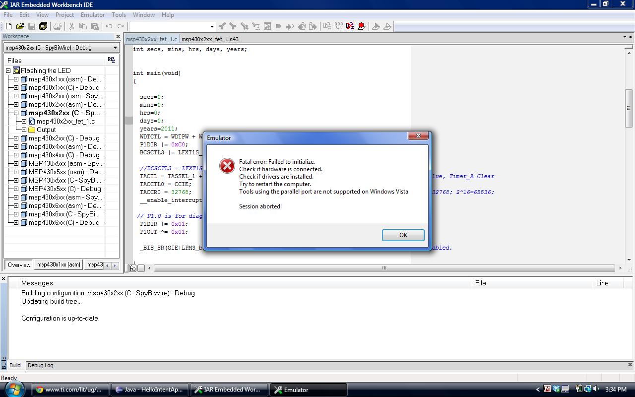

I tried to program the MSP430F2013 using the ez430 USB kit. I disconnectedthe original little daughter board with F2013 and connected J1
pins(Vcc,GNd, SBWTCK, TDIO) to my board.
I got an error - Fatal error - "failed to initialize". Screenshot attached.
Should I connect a power supply to my F2013?
-Hithesh

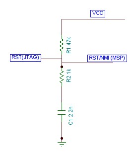

     Hi Hithesh, no power supply is required if power drawn from your board doesn't exceed few milliamp.
     Has your board reset circuitry with a capacitor to ground exceeding 2.2nF? If so and also 2.2nF is a threat, try remove it and test again. Best way is to insert a 1K resistor in series to capacitor to avoid his negative effect on programming and debug.
     Roberto
  • Roberto, I have a 47K resistor connected just like the schematic of ez430F2013.
  •  Hi the 47K resistor is Ok but tis is not in series to capacitor, is between the capacitor and MSP pin node and VCC.
     So in series with capacitor must be in series with no other rail to node.
     Try remove capacitor to see if it work.
