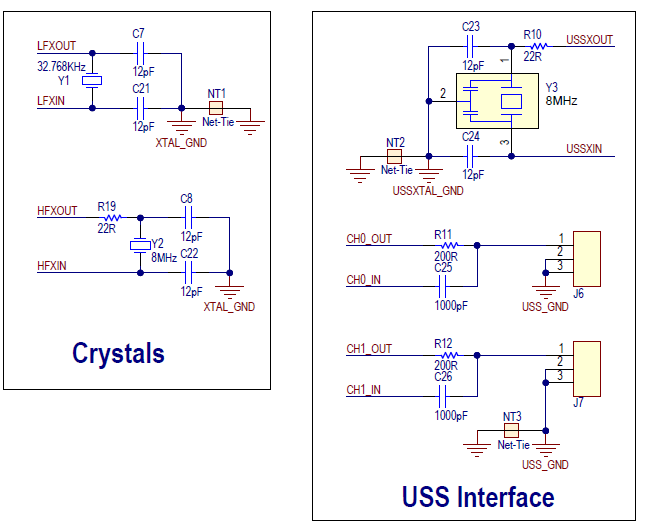

We are developing a custom board for the MSP430FR6047.  The code is based on the FR6047_USSSWLib_template_example, with minor changes to move the uart.
The configuration parameters were generated with the USS Design Center, and we were able to run the template example with them successfuly on the EVM.
On the custom HW, we can see all of the clocks on the scope (LF, HF, and USS) and all look correct.
I am getting an error from
    codeCapture = USS_startUltrasonicMeasurement(&gUssSWConfig, USS_capture_power_mode_active);
        codeAlg = USS_runAlgorithms(&gUssSWConfig,&algResults);
codeCapture = 253,
codeAlg = 126
From USSSwLib.h
USS_message_code_USSXT_oscillator_not_stable_error = 253,
    //!< Value 253 - This error is returned when the USSXT oscillator is not
    //!< stable after start-up time
USS_message_code_algorithm_error_no_signal_detected_ups_dns_channel = 126,
    //!< Value 126 - This error is returned if no signal is detected in UP AND DOWN stream channel.
    //!< The results return by USS_runAlgorihtms or USS_runAlgorithmsFixedPoint
    //!< are invalid if this error is returned.
There is no signal generated at CH0 either.  What would make the oscillator unstable?  How can I fix it?

From the board schematic:
