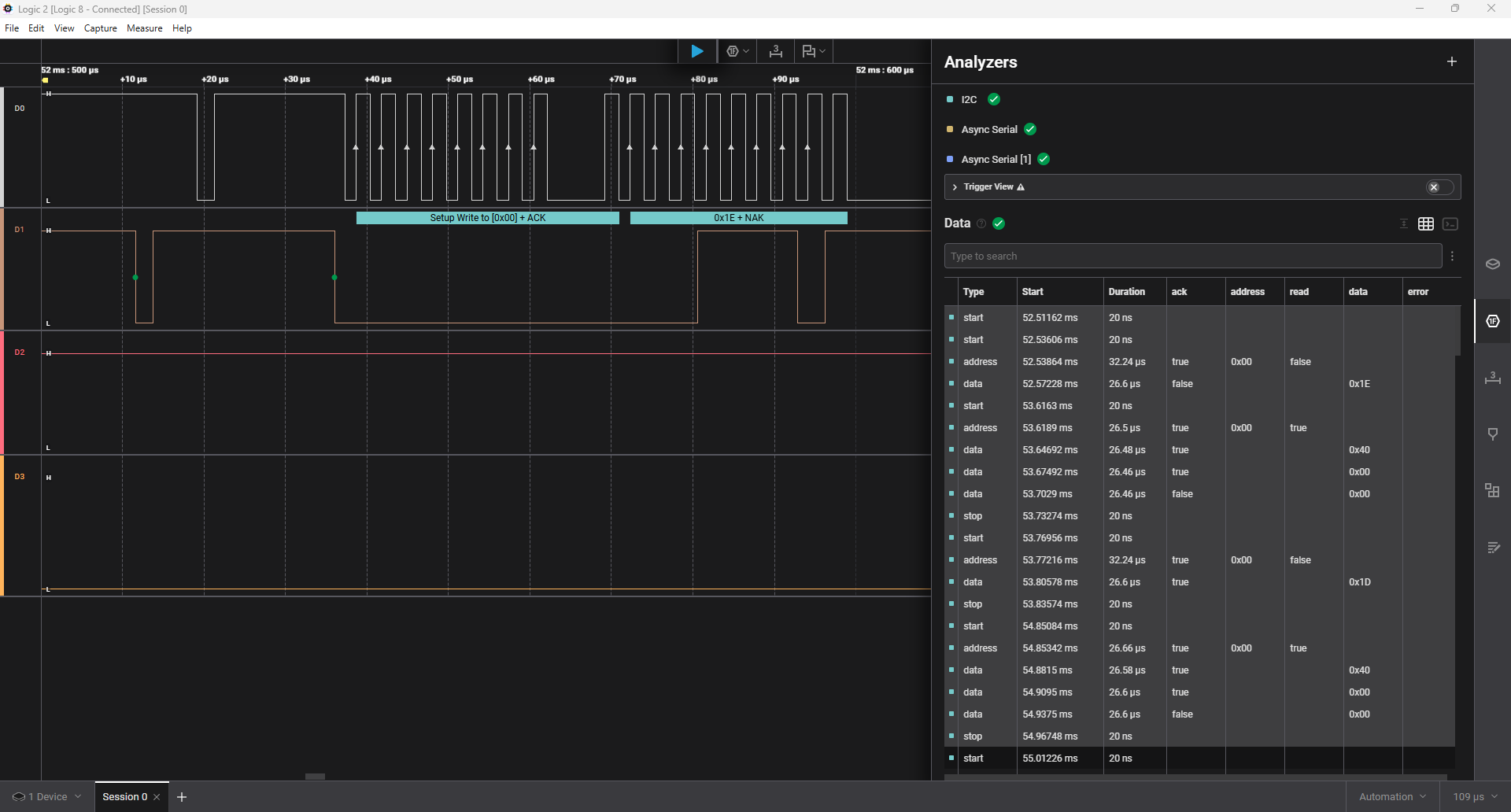

The MSP430FR2355 creates I2C two start conditions after initialisation, so the first byte I send to an ADC is corrupted:

  • 1) On the bus, I see a Start followed (immediately) by a Stop. As far as I know this is legal/benign in I2C, but it's rare enough that I suppose it might bother some slaves.
    2) That said, I think this has to do with the use of GPIO_setAsPeripheralModuleFunctionOutputPin(), which sets the DIR before handing the pin to the I2C. Since the initial OUT register value is undefined, if it is =0 you'll get a brief low on the pin. I suggest using  GPIO_setAsPeripheralModuleFunctionInputPin() instead. This is what example eusci_b_i2c_ex1_MasterRxMultiple.c (e.g.) does.
    3) Unsolicited: The signatures I see for those two GPIO functions have 3 arguments (port, pins, mode), not 2. How does that code work exactly?
  • Yes, your right. Using GPIO_setAsPeripheralModuleFunctionOutputPin caused the Prpblem. Thank you very much.
