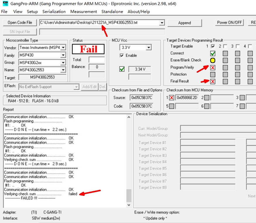

Our customer is using C-GANG loading program to the C-GANG.
They encountered an issue where, after flashing program A to the chip, flashing program B resulted in a checksum error.
If they check the "reload code file" option and flash Program B, they will encounter a checksum issue.
The customer needs to perform the following operations (click auto prog, verifity access, erase flash, blank check button) to flash the new program.
Guide the customer through the correct steps for programming new firmware, including how to program the new firmware in standalone mode.
