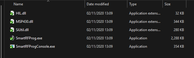

I was able to do this quite easily with SmarthRFProg just by adding these files as a project resource
Using "Generate Standalone Command Line Package" in UniFlash creates a zip file 105MB with 472 folders & 3445 files!
