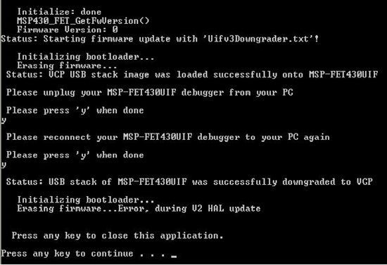

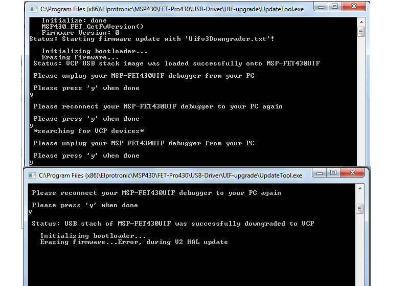

Slight digression. When trying the first FET430 with CCS5 I tried to upgrade the firmware on the device. I think there was an error in that process, but I can't remember absolutely. And nor can I give you a text of the specific error. Anyway, I have now tried downgrading the firmware of the fet430 to v2 using the scripts prvoded to us, but unfortunately that gives me an error (error is bolded):

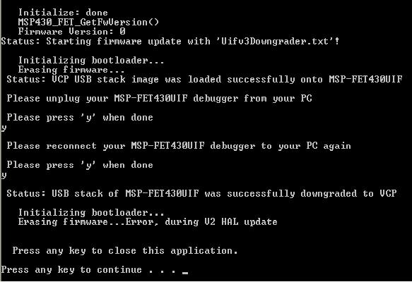

   Initialize: done
MSP430_FET_GetFwVersion()
Firmware Version: 0
Status: Starting firmware update with 'Uifv3Downgrader.txt'!
Initializing bootloader...
Erasing firmware...
Status: VCP USB stack image was loaded successfully onto MSP-FET430UIF
Please unplug your MSP-FET430UIF debugger from your PC
Please press 'y' when done
y
Please reconnect your MSP-FET430UIF debugger to your PC again
y
Status: USB stack of MSP-FET430UIF was successfully downgraded to VCP
Erasing firmware...Error, during V2 HAL update
Press any key to close this application.
Press any key to continue . . .

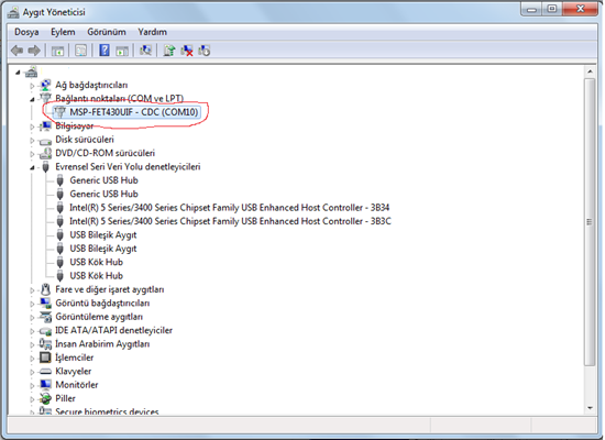

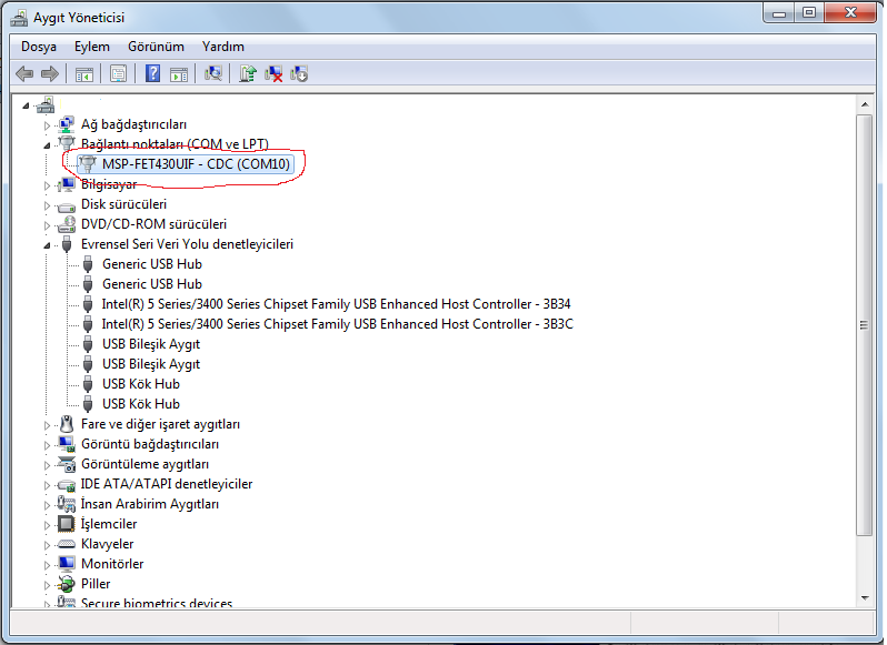

I looked at the COM ports that are allocated for the two devices. The first uses COM9 and the second uses COM10. I changed the COM port for the first to COM17 (which isn't in use). Resetted CCS, tried debugging, and error finding device again.

    CCSv4 uses VCP driver (DLL v2) for the MSP-FET430UIF whereas CCSv5 uses the CDC driver (DLL v3). Therefore you will need to upgrade FET Tool which has a v2 Firmware.
    Can you please provide the information which MSP-FET430UIF version do you have? 1.3 or 1.4x? All 1.4x debuggers have a version sticker on the bottom (V1.4 or V1.4a) of the enclosure. Older v1.3 interfaces don't have any stickers.
    It seems that you are using an v1.3 debugger. Older v1.3 debugger require an extra step (manual power cycle) for the upgrade. You probably got the below error message when trying to upgrade:
    However this error is normal and belongs to the upgrade procedure.
    Please check it here under MSP-FET430UIF interfaces Rev. 1.3 update procedure:  http://processors.wiki.ti.com/index.php/MSP_Debug_Stack#Upgrade_process_to_MSP430.DLLv3
    All you had to do was to unplug the FET tool from USB and replug it and pressing the debug button again. I assume that, iInstead you tried to downgrade the FET tool to V2 and it gave you the V2 HAL update error. This is because the FET tool was updated only the half way.

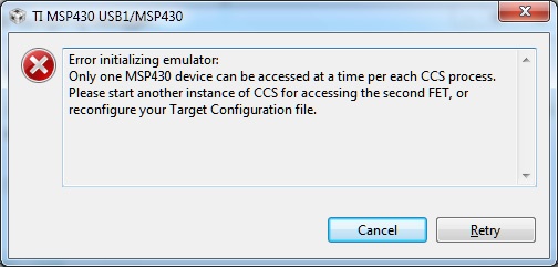

    3) Connect the FET tool with which you got the V2 HAL update error. (You can only have a single MSP-FET430UIF connected for the update)

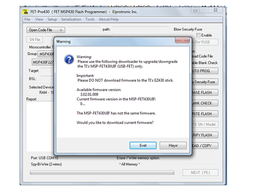

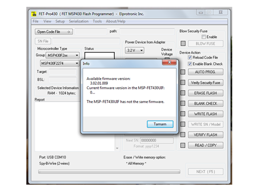

    How to check the current FET Firware version:
    You can use the Elprotronic FET-Pro430 Software (it is a free third party tool): http://www.elprotronic.com/files/FET-Pro430-Lite-Setup.zip
    Go to Tools-->Read MSP-FET430UIF Firmware version

    MSP430: Error initializing emulator: A firmware update is required for the MSP430 Debug Interface (MSP-FET430UIF). Click the "Update" button to update the firmware and launch your debug session.  DO NOT UNPLUG THE INTERFACE DURING THE UPDATE.
    MSP430: Error: MSP-FET430UIF Firmware erased - Bootloader active
    I ran the elprotonic program and it says that the firmware version of my FET430UIF device is 0 (this was before I tried steps 1 to 6)... that seems very wrong. Is there a means of manually resetting the device to its factory defaults? Or is that a last step that shouldn't be taken unless needed! The second FET programmer is still working fine.

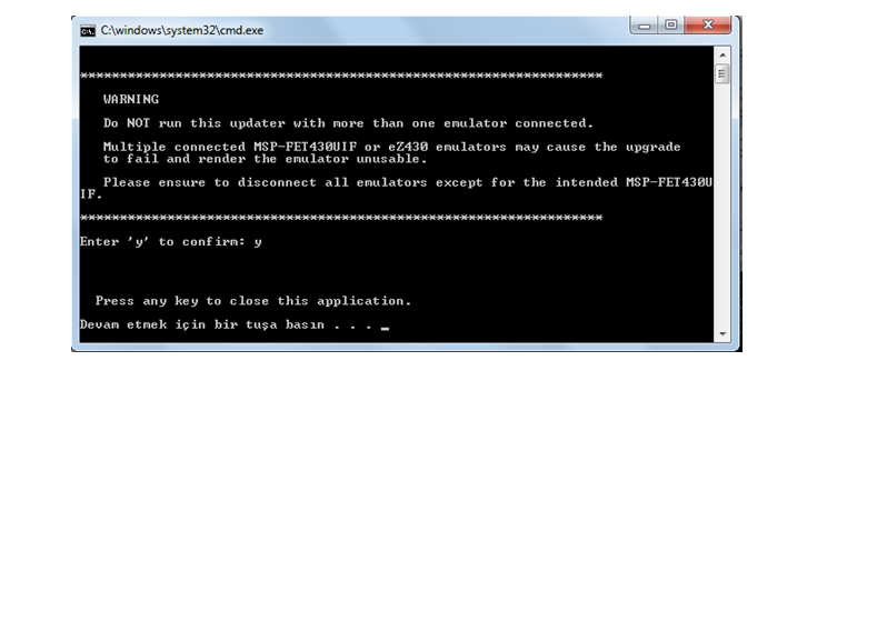

  • And if I try to upgrade the firmware I get:
       Enter 'y' to confirm: y
    Initialize: done
    Firmware Version: 0
    Status: Starting firmware update with built in image!
    Erasing firmware...Error, firmware update returned an error

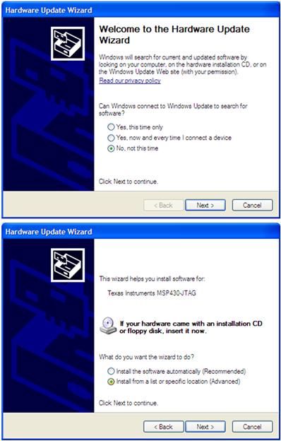

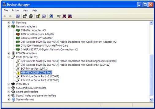

  • Your problem might be related to the Windows USB driver. Make sure the device is properly installed by reviewing the Control Panel / device manager window. If you have one of those yellow exclamation points you will have to update the driver:
    Right click on the device and select to update the driver, which can be downloaded from the wiki page:
    http://processors.wiki.ti.com/index.php/MSP430_JTAG_Interface_USB_Driver
    Make sure you do not allow windows to select the driver.
    Once the USB driver is properly installed, you should see a vitual comm port (VCP) item in the list of devices. After that, allow CCS or IAR to update the debugger firmware appropriately.

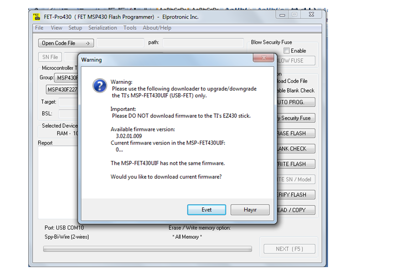

  • I encountered the same situation here, had a FET tool with v3 firmware as I had been using with IAR Kickstart v5.40. Needed to use FET tool with IAR v5.10 and it wasn't compatible with the FET firmware.
    So I ran the TI FET downgrader to go from V3 to V2.
    It ran and failed half way through, where it repeatedly asked me to disconnect and reconnect the FET tool. There were no LED's and running the downgrader again resulted in it exiting with error as it could not find a tool.
    So after trawling through the forums and seeing lots of people in a simlar situation I started experimenting. I found that I was able to recover the FET tool using the following convoluted method.
    • Open windows 'device manager'. Most likely you will see the FET tool listed with a yellow exclamation.
    • Right click and 'uninstall device'
    • Unplug the FET tool.
    • Download the correct driver for your computer, I'm Windows 7 so used this http://processors.wiki.ti.com/images/6/6a/TUSBWINVCP_Win7-32.zip, otherwise just look on http://processors.wiki.ti.com/index.php/MSP430_JTAG_Interface_USB_Driver
    • Extract these somewhere convenient.
    • Plug in the FET tool and guide it manually to the drivers you just extracted. That should update the drivers and at least sort out any VCP enumeration issues.

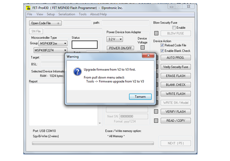

    • Now the next bit may have different ways to do it, but I had Elpotronic LiteFETPro30 installed, so I used it to do this.
    • Download it at http://www.elprotronic.com/files/FET-Pro430-Lite-Setup.zip
    • Within this tool there is a firmware updater tool under 'Tools' menu.
    • Open that and start the process, it may list the current firmware version as '0'.
    • Let the process continue and hopefully the firmware will get upgraded to the latest, LEDs will be back on and FET is recognised.
    • Now I ran the IAR V3 to V2 downgrader again
    • This time it was successful and took much longer as well as there was an extra programming stage that did not happen first time round.
    • I ran up IAR kick start v5.10 and used the FET, now it detected an out of date firmware but it updated the FET tool itself and worked fine.
    Completely mad process, but I really though I had a dead FET tool after the downgrade failure, so maybe this will help somebody out there.
    I also realised that on the first attempt which failed, I had a FTDI USB - serial converter cable plugged into my machine, perhaps this confused things, I don't know, but I ensured it was out second time round as well.
    Good luck and I hope it works for you.

  • I had the exact same symptoms, but the steps just almost worked for me - when trying to downgrade with the downgrader tool from within Fet-Pro430 it always responded  (in cmd prompt mode) that it could not connect to FET.
    I tried this numerous times on several PCs and it didn't work until i tried to click "Auto Program" - where i got to FET-Pro430's own updater window - this one worked like a charm.
    So, in addition to the above, one might also want to try to click auto program inside FET-pro 430 if the downgrader/upgrader tool doesn't work - just wanted to share my 2 cents.
    A side note - there doesn't seem to be any VCP drivers that will allow to install under Windows 8 (yet).

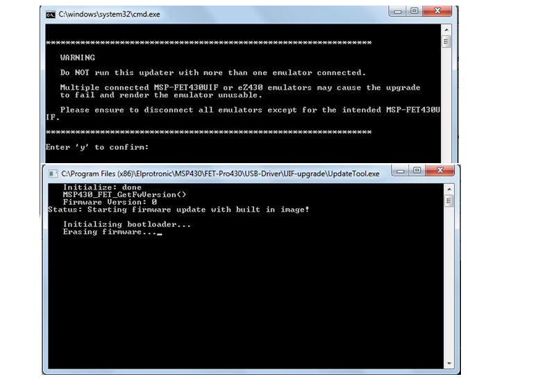

  • Enter 'y' to confirm: y
       Initialize: done
       Firmware Version: 0
    MSP-FET430UIF Firmware version=0
    I tried every way but FET could be not worked. HELP ME.................
