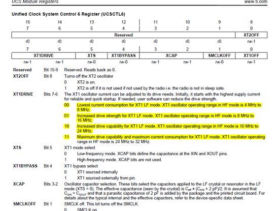

Can the XT1 in the CC430F5137 run in HF mode with a crystal of 16MHz ??
I have been trying to make the XT1 work with diffrents crystals (8, 16 MHz) but I'm always getting the XT1HFOFFG oscillator flag set. I'm doing whats indicated in the CC430 user manual (slau259b) but without success.

    I agree, the datasheet for the CC430F5137 (slas554E) does not mention the HF mode for the XT1 but Its all over the place in the USER MANUAL (slau259b) of the CC430 family including the CC430F613x, CC430F612x, CC430F513x.
    So whats is considered HF mode for the XT1 on CC430F5137.
  • I agree the user manual (slau259b) is confusing about XT1 HF mode. Based upon the user manual I think the CC430 devices don't support a HF crystal for XT1 since:
    1) Figure 3-1. UCS Block Diagram only shows a LF oscillator symbol for XT1:
    2) The only mention in section 3.2.4 XT1 Oscillator of  HF mode is feeding in an external clock signal:
    XT1 may be used with an external clock signal on the XIN pin in either LF or HF mode by setting XT1BYPASS. When used with an external signal, the external frequency must meet the data sheet parameters for the chosen mode. XT1 is powered down when used in bypass mode.

    Yes the oscillator block diagram shows the LF symbol. But puzzle me its that I'm also trying their Bypass mode in HF and still does not work.
    According to the user manual, if the bypass mode is used the XT1 is powered down. In that case one should only make sure the square wave clock into the XIN should meets the digital input's specs of the MSP430.
    I have tried the latter and many other configuration without success.....;(

  • Table 54. Port P5 (P5.0 and P5.1) Pin Functions of the CC430F5137 datasheet SLAS554F shows that the P5SEL.0 bit must be set to use P5.0 as XIN bypass mode. Does your code do that?
    Since you seem to be using driverlib the following could be used:
    GPIO_setAsPeripheralModuleFunctionInputPin (__MSP430_BASEADDRESS_PORT5_R__, GPIO_PORT_P5, GPIO_PIN0); //XIN
  • If you look at "Crystal Oscillator, XT1, Low-Frequency Mode" in the CC430F5137 datasheet, it specifically states that the square wave in bypass mode should be between 10 and 50kHz. To my knowledge it has no support for XT1 HF.

  • Hello, Ok so I have been testing on the bench the CC430F5137 and all I can get the device to do is to accept an low frequency crystal on XT1. I have also tested with a digital clock in in bypass mode without success. My code is correct and has been verified by enabling the XT1 oscillator only in LF mode. In fortunately, the manual for the CC430 lett us to make a wrong design decision. The manual mentions the HF mode and defines registers for enabling the use of high frequency cristals...... In our case this will be very costly....unless we figure out a way to use the oscillator XT1 in HF mode (16MHz) Dave
