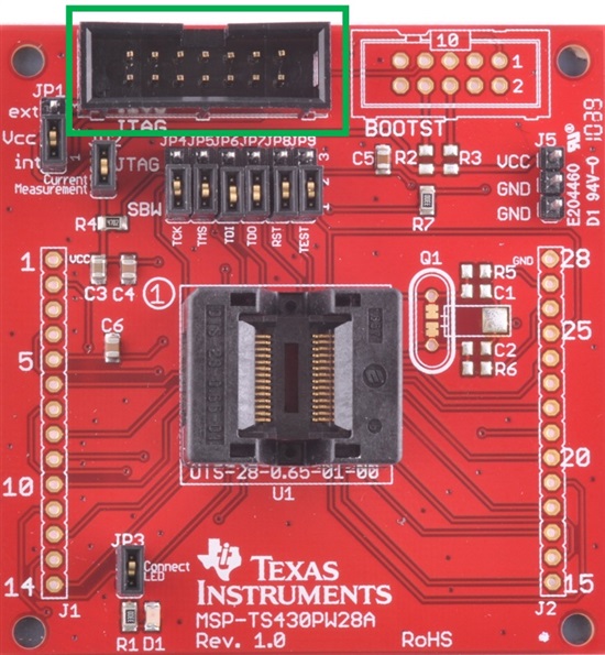

    Yes, 8 JTAG cables come with the GANG programmer. One end of each JTAG cable will plug into the GANG, but the other end of each JTAG cable will plug into one of the target boards which you are trying to program. The MSP-TS430PW28A has one of these JTAG headers on the board (see pic below, outlined in green), but what I'm saying is that if you have enough room on the PCB you are using for your end product, you can place one of these connectors with the components shown in figure 2-1 of the Hardware Tool's User's Guide on each of your boards and do in-circuit programming with the GANG.
    Basically it depends on if you want to program the MSP430 before or after it is soldered onto your final application's board. The tradeoff is having to buy/spin boards with sockets to be able to program parts before they are soldered on your final board vs. the space it takes to add this JTAG header connector and components to your board to be able to do in-circuit programming after the device has been soldered down. One additional benefit of having JTAG headers on your final board is that while prototyping it is easy to re-program your board (unless you've blown the fuse of course), but the JTAG header may not make sense if you are short on board space.
    So it is up to whatever method makes the most sense for your particular application. Using the MSP-TS430PW28A may be the option you want to go with, I'm just trying to let you know all of the possibilities.
