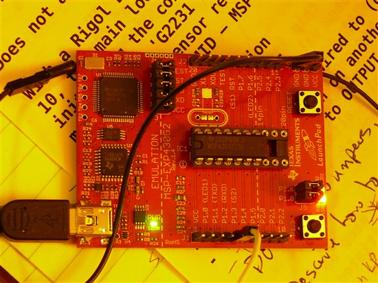

I have code running on a LaunchPad/'G2231 that does three things:
 1) Blinks an LED with a "220" ohm resistor on P1.4,
 2) Monitors/debounces the LP S2 button, and
 3) Samples the internal temperature sensor (ADC10 channel 1010b).

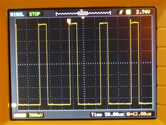

The LED is driven with a "manually-generated" PWM signal timed by Timer_A0 (4000 interrupts/sec).  The pulse rate is 2 Hz -- 2000 Timer_A ticks -- and initially the PWM "ON" period is 10 Timer_A ticks, for a 10/2000 or 0.5% duty cycle.
Each time S2 is pressed, the ON period is increased by 10 more ticks.
Meanwhile, in the background, ADC10 is sampling the internal temperature sensor watching for signs of heating up, that is, an ADC10(1.5Vref) value of 757, which ought to represent 35degC.  If this happens, it shuts off the external LED and turns on LP LED2 (green) to signal a problem.
So far, so good.  One might assume that a "too hot" condition would never be achieved, since the chip is only powering itself, Timer_A0, ADC10, and the external LED.
And so it seems... Running under 'mspdebug' and periodically stopping to check the ON tick counts and current temperature, I gradually increase the pulse width to 200 (of 2000) ticks and all is well: the LED flash is _slightly_ longer, and the internal temperature stays in the range 0x02d6-0x02da (726-730, or 22-24degC).
Then, somewhere between 250 ticks and 500 ticks, Something Happens: ADC10 unexpectedly reports a value exceeding not just the 757 "trip point" but well above it, in several cases reporting values of 0x3ff (144degC).

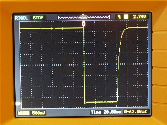

    Since my initial post I have added a trace buffer to see how abrupt the "temperature change" is. Here's a sample dump from the debugger:
      (mspdebug) md pulse_on_ticks
          00204: 90 01              400 decimal (20% duty)
      (mspdebug) md final_temp
          00214: 76 03              886 decimal
      (mspdebug) md tt_index
          00218: 02 00              tt_buffer[2] is the next entry
      (mspdebug) md tt_buffer   (last 16 ADC10 temperature values)
          0021c: d2 02 76 03 d2 02 d3 02 d2 02 d3 02 d2 02 d3 02
          0022c: d1 02 d2 02 d2 02 d3 02 d2 02 d2 02 d2 02 d2 02
    In other words, the raw "temperature" value reported stays steady around 721-723 (0x02d1-02d3), and then, within 1/3200th of a second, rises to 886.
    Using the formula Tc = (( ADC10 * 0.413) - 277.75 ), the jump is from 20.0-20.8degC to 88.2degC.
    I haven't tried capturing samples following a "bad" reading, but I'd guess that they would be close to 20degC.
    Frank
  • A minor update:
     - I have succeeded in triggering an "odd" reading without using the debugger. (I can tell this has happened because when it occurs my code turns LP LED1 on and starts blinking LP LED2.)
     - I have also reproduced it without the debugger and with no external LED attached.
    This leaves Timer_A and its interrupt handler, and ADC10 and its interrupt handler. And S2. And the 'G2231. And the LaunchPad board itself. (And three other things I haven't even thought of. <grin!>)
    Frank

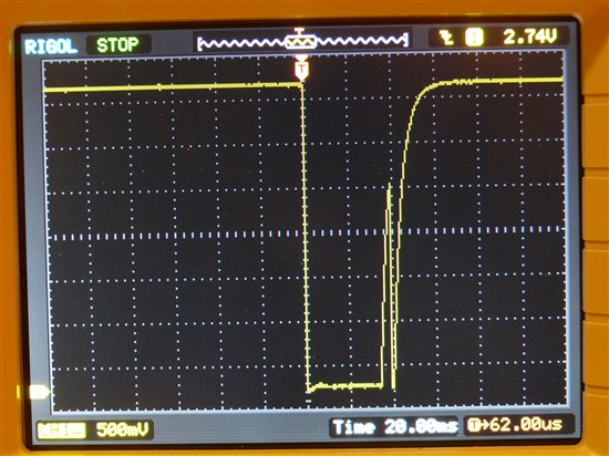

    I have an update on the sequencing. I added code which continues tracing the next 8 temperature sensor values after an anomalous one is seen. Here is one such sequence, with the 7 values preceeding the anomalous reading, the odd value itself, and the next 8 values read from ADC10:
    Hex:  2d5, 2d3, 2d4, 2d5, 2d5, 2d4, 2d5, <<  354 >>, 2d4, 2d5, 2d4, 2d4, 2d5, 2d5, 2d4, 2d4
    ADC10CLK is now 500kHz, and I'm sampling at roughly 6.5k samples/sec.

    For your amusement, here's a 'scope display showing what happens on P1.3 when S2 is pressed (no hiccup occurred this time):
    ( And people wonder why buttons, switches, and other mechanical contacts need to be debounced! <grin!> )
    Here's a pulse from S2 that did trigger the effect:
    and here's a trace of the main loop. "High" is when we're spinning on ADC10BUSY, "low" is all the rest of the loop.
    This is one of the V1.4 LaunchPad boards after the problem has been triggered: LED1 is on solid, LED2 is flashing at about 8kHz. The black and orange wires connected to Gnd and P1.6 go off to my 'scope, and are not required to reproduce the problem.
    Debugging any intermittent problem is always a pain the flying buttress.  With a nice, reliably reproducible problem you can pare away code and see if the problem vanishes, but when you're dealing with an occasional "hiccup" it can take a long time to verify that what you just did made the problem go away... or brought it back. I would like to thank all of you who offered suggestions and comments during this rather painful process. <grin>
