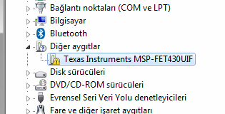

I have 2 nearly identical computers - both running Windows XP SP3.  I have installed CCS v5 on both.
One computer works fine with CCS v5 and the MSP430 LaunchPad.
The second refuses to connect to the LaunchPad - the error message is:
     Error Initializing emulator:  Could not find MSP-FET430UIF on specified Com Port.
When I plug in the LaunchPad:
     The computer that works shows a Texas Instruments XDS560 PCI JTAG Emulator in the Device Manager Window.
     The computer that doesn't work shows a USB Human Interface Device for the LaunchPad driver - Not a TI XDS560 PCI JTAG Emulator.
My question is:
     Is the XDS560 PCI JTAG Emulator driver required to program and debug with the LaunchPad?
     If so, where can I get it, how do I install it, and how do I convince my second computer that it should not use the generic HID driver?
