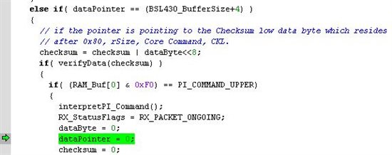

  • Thank you very much! Unfortunately, I'm still having the same problem.. I'll try to be more specific. I am using the USCIA peripheral instead of the Timer A peripheral, and I'm debugging within the PI_receivePacket() function. The first line is:
    char RX_StatusFlags = RX_PACKET_ONGOING;
    I set a breakpoint on this statement:
    and step to the Next Statement, and it jumps all the way down to:
    and completely skips everything in between. Why does this happen????
  • Matt,
    you might want to check the compiler optimization on the IAR. Go to "Project" -> "Options" as shown below:
    Debugging with compiler optimizations set to "High" might give you headache :), so set it to "Low" to make the debugging process more understandable.
    -Leo-
  • Ah, thank you so much!
  • Just to add an explanation why optimization can cause this:
    Thsi statement might be common to more than one part of the code. Or won't change the program flow if done on a different location. maybe it will allow the usage of register variables or re-use of comparison results if done somewhere else. The compiler will detect this and actually move it out of the IF clause. The debugger, however, reaches the binary code location, and all it knows is that the source code that caused this binary code, was on this line. So it shows the break there. And this does not necessarily mean that the next instruciton executed is the next isntruction in the source code.
    It makes debugging a really confusing process.
    So compiler optimization, which han shrink code size by up to 50% while at the same time increasing execution speed, should not be used for debugging the program (if the available and required flash size allows it).
    However, switchng it on after the program works means that the program needs to be tested again, since the timing will have changed (and reveal previously undetected code flaws). Also, in some rare cases, compiler optimization will break working code due to unexpected side-effects. Mostly related to undetected compiler bugs, but sometimes due to sloppy code that coincidentally worked without optimization (and probably would have failed on the next compiler version anyway, even without optimization)
