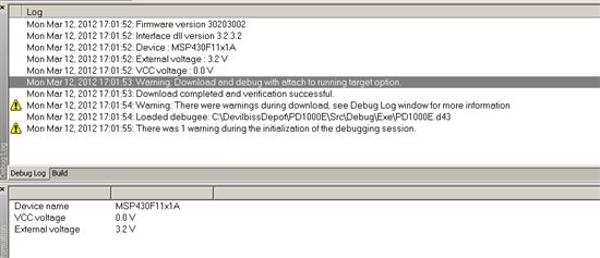

    I got a new target board and it downloaded but had this error:

  • Since you get the message that your code was downloaded and verified successfully (line 7 in your screen shot), I'd say that your debug tool is working fine.  Just to be sure though, why don't you make a really simple program (or use one of the simple examples provided for your device) and see if you can download and debug that?  That will at least set your mind to rest that your tools are working OK ( been there!! ).
    Based on my limited experience though, I think you've got a software problem.  Can you single step your code at all?  The fact that you can -see- your stack as something other than "ffff" is another promising indicator that your hardware is OK.

    So I went back to my project and looked at the FET tool setup.  When I had the switch in the wrong position and everything was not working I decided to change some FET tool settings. Iselected "Connect to active project" and "Verify Download"  Then I realized the the switch was in the wrong position but never changed back the FET tool settings.
    I deselected "Connect to active project" and "Verify Download" and I have my switch in the correct position and it now works.
