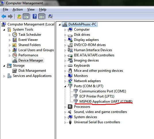

I want to send data from msp430g2553 to PC using uart mode of usci module. I use this code in code examples but it don't work. Please help me! What's wrong with it?

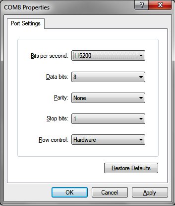

And this is my configure of HyperTerminal. ( I've already chosen right port of msp launch pad!)
    You need to set your Flow Control to None in hyperterminal.  Also running 115200 baud with a source clock of 1 MHz has high error rates. You should have better luck setting your SMCLK to run at 8 MHz.
    HTH,
    Barry
  • Thank for your help!
    I  set your Flow Control to None in hyperterminal as you said and you use this code but it still doesn't work. Running in these clock and baud rate have low error rates according to user's guide.
    May you give me a code that can run !
    Thank you so much!

  • Assuming that you use the LaunchPad, the baudrate is limited to 9600Bd. The USB/ser converter on the LaunchPad won't accept more.
    Also, check the jumpers on the board. The hardware UART pins on the G2553 are twisted against the original wiring on the older G2 LaunchPad chips with software UART.
