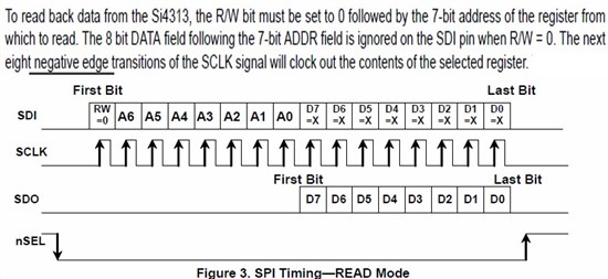

First time I'm using SPI and as slave is a tiny QFN was not sure if it was working.
Spent 10 hours trying to get it to work.
FINALLy sucess with:
bis.b   #USIIE+USICKPH,&USICTL1         ; Counter interrupt, flag remains
Is that common that you need  USICKPH set?
    Not all SPI devices use the same clock phase / polarity, and therefore the clock phase / polarity has to be selected according to the SPI device being used.
    The SPI Mode of the Users Guide for the MSP430 family has a Serial Clock Polarity and Phase diagram which shows the effect of the UCCKPL and UCCKPH control bits. Based upon the timing diagram for the Si4313 the correct settings are UCCKPH=1 and UCCKPL=0 which matches your working code.
  • The TI phase interpretation is different from the Motorola one.
    So setting USICKPH is the 'usual' configuration for many (but not all) SPI slaves out there.
