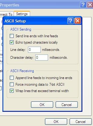

    I am also wondering if you have something like the following enabled in the hyperterminal that you are using:

  • akash satapathy said:
    i am not getting anything from the microcontroller in the hyperterminal, instead whatever i type is just getting echoed
    Either you have local echo option enabled. So everything you type, is just shown on screen, but the MSP never receives it.
    Or the code on teh MSP isn't the code you posted.
    The original demo code has the line
    TXBUF1 = RXBUF1;
    where you have
    TXBUF1=0x42;
    And this would exactly do what <ou experience: echoing everything.
    What your code should do is: when an RX interrupt is received, the code waits for TXBUF ebing clear, then it sends 0x42 ("B"). Then the ISR exits, and because you didn't clear the RXIFG bit (you never read RXBUF1 or manually clear the IFG bit). the ISR is executed again immediately. And again. And again....
    So after the first keypress, you should see an endless line of 'B's. Whcih you don't.
    So one of two things (or both) happen:
    1) local echo is on and the MSP is deaf and silent. Which could be because of a faulty physical connection (how did you connect the MSP to the PC? With a proper level shifter? The MSP requires RS232 signals, the MSP TTL signals. Is MSP TX connected with PCs RxD adn MSPs RX with PCs TxD?)
    2) you never uploaded your modified software to the MSP but run it in simulator instead. So the original demo software is still running on the MSp, echoing everything that comes in.
    If the demo was an imported project and you started a new one for the modified code, the new project maybe is still configured to use teh simulator, not the emulator. (I wonder why this is still called 'emulator' when it actually uses the real MSP - so much cause for confusion! Well, FET means Flash Emulation Tool, but it doesn't emulate flash at all for the last many years now )
