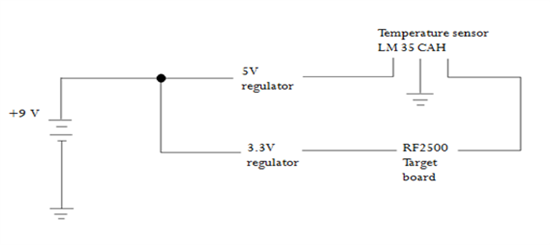

  • Hi all, My team and I I have managed to solve the problem with regards to the LM35, We used a single 9V power supply and powered up the the LM35 and RF2500 using 5V and 3.3V regulators respectively.
    Now, my team have managed to connect the analog output of the LM35 to analog input P4 of the RF-2500.
    My next question would be, what are the codes that is needed to be edited in the eZ430-RF2500 Sensor Monitor Demo v1.02.eww ? Will it be displayed in the wireless sensor monitor based on the edited codes in the .eww file?
    Hope to hear from you all soon, developers :)

  • Hi there, my knowledge of the project might be a little rusty but nevertheless, here is what I can provide you :) Btw, it did display the temp on my comp perfectly :)
    My project was a chronos working together with the rf2500.
    here are the codes:

  • Hi, Thanks for providing me this circuit diagram and your response
    Can you tell me at which point of the target board should i use 1) from the sensor to the target board 2) from target board 3.3 regulator?
    Have you done this project or connection before?
    sy
    THanks
    We have done this before. I cant really remember which pins, I gotta dig my archives. In the meantime, the answer to your question actually lies within the datasheet. Suppose you have some form of knowledge of I/O of MCU's. It should be pretty straightforward. If you dont, then be prepared to burn a few chips. If your chip has burnt out or spoilt, the light will just blink if I can remember correctly and no data will be transmitted. If it heats up, you know, you have done your grounding wrong and your chip is as good as a keychain.
    try look at inputs 4,5,6 and 8. If my memory serves me well, either 4,5,6 was for power and ground and pin 8 was for the input of whatever signal you are trying to transmit.
