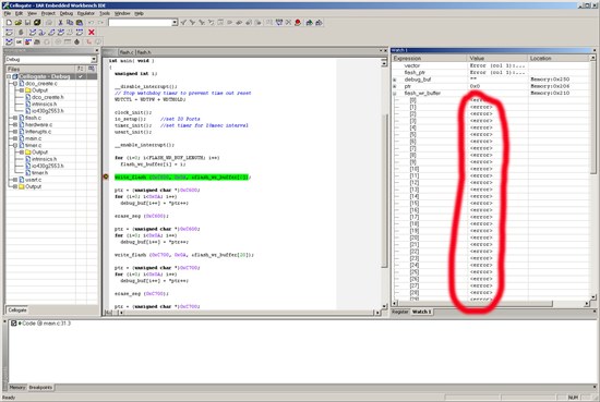

I'm trying to verify my flash write / erase functions work and I realize I can't view variable's vlaues in watch.
I use MSP430G2553 with Launch Pad debugging using IAR embedded workbench 5.40.1
I attached a picture

    In the example pic the variable circled is a global variable
    I have optimization disabled.
    so the problem is elsewhere, any ideas?

    as of  "flash_wr_buffer" - it is a global array of unsigned char.
    It doesn't matter, it happens all over. if you'll see in the pic the following line loads an address to a pointer (ptr)
    currently the watch says ptr points to 0x0, but after executing this line ptr in the watch has "<Error>" as well.

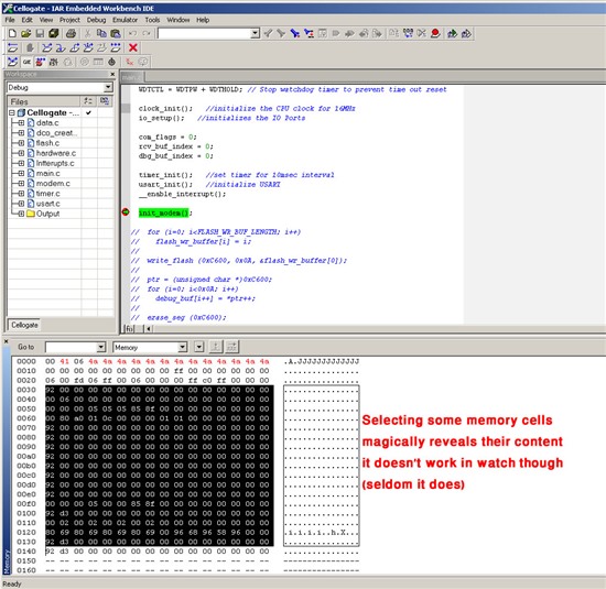

    going to View---Memory (from the IAR main menu) instead of seeing the memory (either RAM or program memory, it doesn't matter) you'll see "--"
    if I select a few cells some of them show their values. I will embed a couple of pics down here to illustrate what I mean.
    trying to see the memory's content:
    after selecting several cells:
