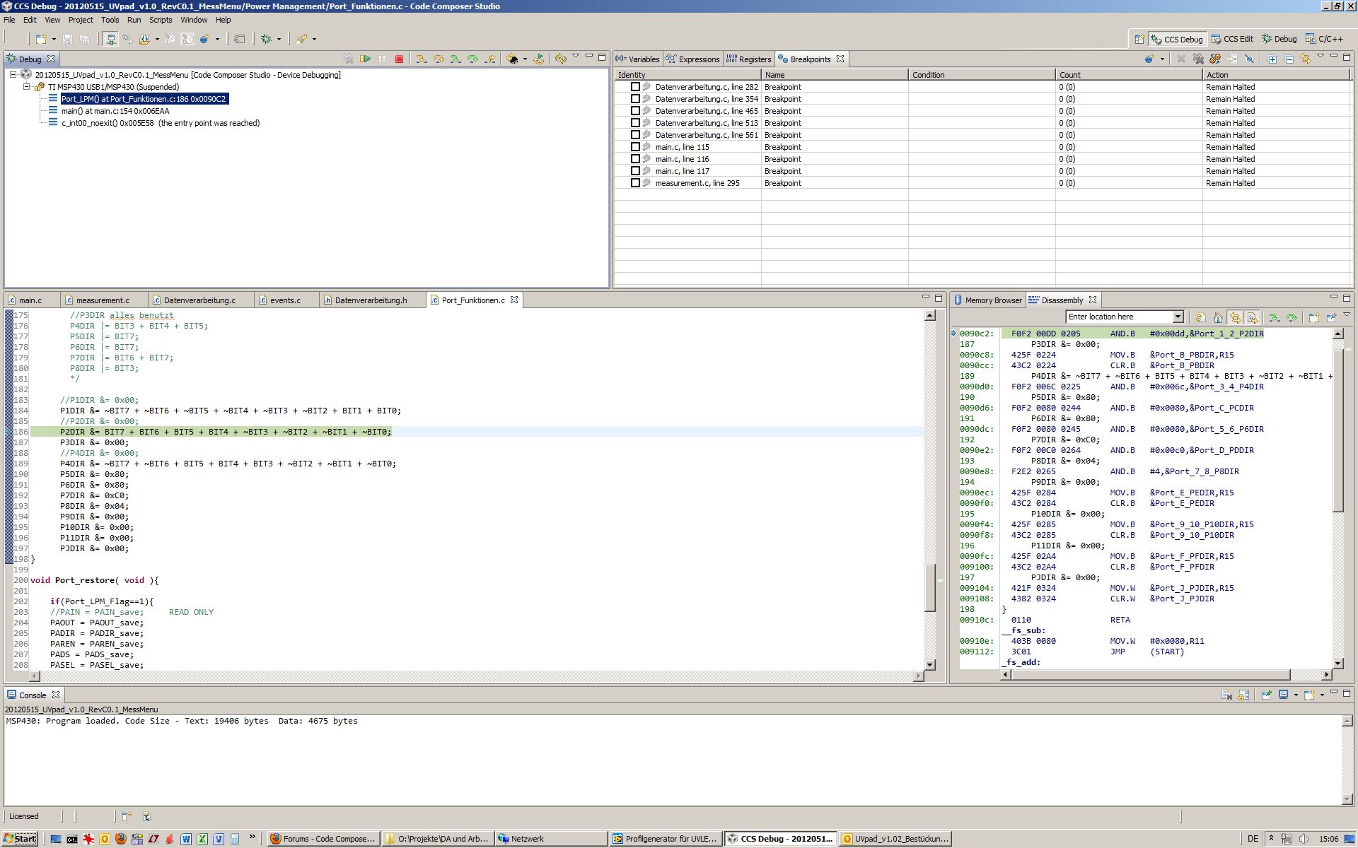

  • Hello I do not know if something is explainable on this screen. ( I now reviewd it and I guess it is big enough :) ) So anyway, on the screen you can see my CCS Debug window, You also see that there is NO breakpoint active, and the point where the pointer stopped is just some random code section.I did not single step into it, it just stops around those lines of code everytime I dstart debug. I can resume my debug though. After resuming once everything seems to work fine, also with breakpoints active. Of course I kind of could work with this bug, but it would be rather nice to have it working correct, especially because I get some more bugs like this, once I enter LPM3 in my code and start from the beginning ( which is intended by me and my software).
    My problem is kind of reproduceable. Every time I start debugging in my code code flow will stop  on some certain point, somewhere before LPM3 is entered, but it is NOT always the same instruction where it stops, but it is always in the same *.c file, which is noch the main.c
    I found some threads about unreasonable behaviour of breakpoints after entering IRQs. Though I am not having trouble entering my IRQs, its just that after I start debugging my Code it randomly stops in some instructions and I cannto say why this is.
    Thanks for taking care of my problem, hope there will be a solution.
    BEst wishes
    Seb

    thanks for the fast reply, I wont be able to send you an exact code, since it is pretty long:
             name            origin    length      used     unused   attr    fill
    RAM                   00001c00   00004000  00002e05  000011fb  RWIX
    FLASH                 00005c00   0000a380  00006035  0000434b  RWIX
    And of course it is my code or that form our company  and I dont want anyone to take a close look at it :)
    What I will try to do is establish an minimal exampel. I will keep this post edited up to date now, spending a couple of minutes tweeking my code.
    1. I tried to disable all Interrupts by out commenting all the _EINT() instructions but the problem still is the same
    Next step will be to narrow down the code, it will get unfuncional for me but still compileable. So perhaps I will get insight on when this behaviour stops and starts, perhaps it has something to do with code size in general.
    2. I did comment out the enter LPM3 line, to see whether this is some LPM problem, strangely those random breaks occure before entering it, and afterwards also.
    Now the code only breaks in one point ( right when i want to write something to my attached LCD, thats why I also see it clearly where it stops ) before (with the enter LPM3 instructions) it did always stop in 2 occasions, the one mentioned and one before entering LPM3.
    3. I did not enter my real while(1)-loop with a lot of instructions, but did stop right before it in another while(1) with no instructions, still it stops without an breakpoint set, this time it does stop insice the while(1) which has no instructions in it, since it can never leave it.
    This might point something out. Perhaps the code stops after some number of instructions, but I do not know how and when.
    4. I still see inactive breakpoints, i will delete them all out in the CCS debug window
    Same behaviour, this does change nothing.
    5. I will comment out the line where it usually stops, it would make sense if the code stops now the amount of instructions later that i commented out.
    Indeed it seems like he is doing so, stopping a view steps later.
    So looking through all this, I would say somehow I have some breakpoints burned into my device on certain addresses, without me knowing it.
    Another point:
    I see this phenomenon on different boards of mine, as I have right now 2 PCBs that i am testing code on, I can see this behaviour on both of them with this certain code. When I debug prior codes ( that dont have this buggy behaviour) everythign works fine, so I guess I can exclude the PCBs and MSPs from the list of suspicioun :)
    What I cannot try is changing my PC switching to another one, since I only got this one to progam the devices.

    And now TI it is your turn to tell me why the Vcore level is producing wring breakpoints...
    Thanks for still being with me.
    Seb

  • Sorry, I too do not kow why it stops.
    The MSP can set breakpoints not only on a code line, but also when a certain memory location is read/written or if a register changes its value or changes to a specific value. Those breakpoints are AFAIK not listed in the breakpoints view (as these are only position-dependent breakpoints).
    However, your screenshot has shown some other, serious problem, with your source code.
    the line
    P2DIR&=BIT7+BIT6+BIT5+BIT4+~BIT3+~BIT2+~BIT1+~BIT0;
    (and similar others) definitely doesn't do what you intend to do.
    Translating it into values, it does
    P2DIR &= 0x80+0x40+0x20+0x10+0xfff7+0xfffb+0xfffd+0xfffe = 0x(400)dd
    When doing bit operations, you should never use + or -, as these are arithmetical operators. The compiler won't complain as they are (take for themselves) valid operations. And adding bits will give the same result as ORing bits. If, and only if, each bit appears once at max. When using bitfields, or having the same bit twice in the assignments, the outcome of + is totally different from |.
    And when you invert a value (for clearing a bit) you'll set all other bits in this value, so you cannot add to an inversion without completely messing things up.
    If in the above line you want to clear BIT0..3 and keep BIT4..7 at current state, the proper operation would be
    P2DIR &= ~(BIT3|BIT2|BIT1|BIT0);
    FIRST group the bits by ORing them, then invert the result.
    thanks for that tip. I will change my code into doing so. You are right about that, I didnt spent time thinking about it as it seemed right to me. And I do this operation right before entering LPM3, thats why I couldnt see any major issues when proceeding in my code.
    Thank You.
