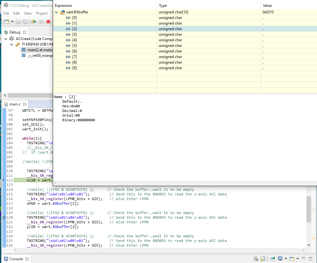

  • Dear Friends
    I am testing the UART communications between MSP430G2553 and BNO055. I am sending 4 bytes as shown below and I must receive 3 bytes
    My question is how can I read these 3 bytes given that the UART buffer can accommodate one byte (as I understand).?
    And how can I read the receive buffer of the UART?
    And how can I turn on LED for a given received data?
    Thank you

  • Neither you, nor your code knows when RX data is arriving. To be able to read RXBUF with meaningful data, first you need to either keep checking the RXIFG in a loop, or enable both RXIE and GIE and catch it in ISR. After that you can read RXBUF for one byte of data.
    To receive three bytes, you need to repeat the above sequence three times.

  • if (data3 == 'A0')
    Warning[Pe1422]: multicharacter character literal (potential portability problem)
    C is not a string aware language.
    What you are doing is this: cmp.w #0x4130,&data3
    Never put a delay inside a ISR!!!!! plus a compiler in high optimization will warn that i is not used and/or just remove it.
    for(i=0;i<20000;i++);    // delay between the toggle.
    Your RX isr will not work like that, learn how to use pointers and length counter.
  • Something like this:
    #define   TXSTRING(pnt) (TXdata((pnt), sizeof(pnt)-1)) // cool macro to get string and string len
    uartstruct uart;                 // declare a struct from typedef uartstruct

    Now what I did is I placed a break point after setting the register of the slave device and sending the reading command. Since I am reading acceleration, then I need to read 6 registers of the slave device (2 registers for the x-axis (MSB & LSB), similar for the y-axis and z-axis). I used the piece below. But with this I can read only one register. How to read 6 register instead of 1 (i.e. using xAA\x01\x08\x01 and changing the 3rd byte each time) and then checking the 3rd byte that I receive in the RX buffer?
    Can I do that?
    Can I check them all?
    while(1){
    	  TXSTRING("\xAA\x00\x3D\x01\x01");       // Send this to the BNO055 to set up the ACC mode
    	  while( !(IFG2 & UCA0TXIFG) );      // Check the buffer..wait it to be empty
    	  TXSTRING("\xAA\x01\x08\x01");       // Send this to the BNO055 to read the x-axis ACC data
    	  __bis_SR_register(LPM0_bits + GIE);     // else Enter LPM0
    	  __delay_cycles(12000);                               // small hard-loop delay
  • Just a unrolled loop is probaly easiest here, as it's only 6.
    BNO055 also have i2c, that I would say is more robust as master is in control of data coming in not like uart when RX always have to be on standby.
    __bis_SR_register(LPM0_bits + GIE);   // Then Enter LPM0
    x = uart.RXbuffer[2];
    TXSTRING("\xAA\x01\x09\x01");         // Send this to the BNO055 to read the y-axis ACC data
    y = uart.RXbuffer[2];
    TXSTRING("\xAA\x01\x10\x01");         // Send this to the BNO055 to read the z-axis ACC data
    z = uart.RXbuffer[2];

    what does the uart.RXbuffer look like?
    Do you see any data filled in?
  • uart.RXbuffer has these:
    uart.RXbuffer[0]: 0xBB.....which is correct, since the response of the BNO starts with BB
    uart.RXbuffer[1]: 0x01...also correct as this indicates the length
    uart.RXbuffer[2] to uart.RXbuffer[9]: 0x00...here is the problem
  • Ok, I commented all the
    and use the debugger to check the RXbuffer (step by step, i.e. after sending the x-axis read command, etc) and there is no change, I am still getting BB 01 00
  • step by step don't work with uart running.
    put a break-point in front of example: yLSB = uart.RXbuffer[2];
    does it hit and what is the data in rxbuffer look like?
    Maybe have to change RX IRQ to a 4, as pointer is incremented before the compare, try it.
    if (uart.bufRXpnt == uart.RXbuffer+4)           // got three bytes in yet?  <<<<
  • Oh sorry, that is what I mean by step by step, I placed a BP and checked, I got BB 01 00
    But BB means the BNO has been red correctly and 01 means there is data of 1 byte coming
  • Edited:
    I changed it to 4, this is what I see.
    so I placed the BP in line 120, but it seems to be stuck in 112 (reading the x-axis)

        UCA0CTL1 &= ~UCSWRST;             // Clear UCSWRST to enable USCI_A0-UART
      IFG2 |= UCA0TXIFG;            // preset IFG flag always left on
      IE2|=UCA0RXIE;  ///today added
    void TXdata( char* pnt, unsigned int len){
      uart.bufTXpnt = pnt;
      uart.TXbuflen = len;
      uart.bufRXpnt = uart.RXbuffer;         // reset it to beginning of ram buffer
      IE2 |= UCA0TXIE + UCA0RXIE;            // enable USCI_A0 TX & RX interrupt
    //¦----------------------------- Delay Function  ---------------------------------------¦
    // This function will give us 1ms wait time, so for getting 10 ms,
    // then delay_ms(10) will give 10ms and delay_ms(100) will give 100ms
    void delay_ms(unsigned int ms)
        unsigned int i;
        for (i = 0; i<= ms; i++)
           __delay_cycles(6000); // 6000 will give us 1ms
    //void delay_ms(int del)     //generates delay in milliseconds
    //	del = (SysCtlClockGet()/3.0)*del/1000.0;
    //	SysCtlDelay(del);
    //¦----------------------------- US0TX ISR  ---------------------------------------¦
    #pragma vector=USCIAB0TX_VECTOR
    __interrupt void USCIAB0TX(void)                    // Shared A0/B0 TX IRQ vector
      if (IFG2 & UCA0TXIFG){                            // our USCI_A0 transmit Interrupt?
        if (uart.TXbuflen){                               // if not zero
          UCA0TXBUF = *uart.bufTXpnt++;
          --uart.TXbuflen;
        else IE2 &= ~UCA0TXIE;                          // suspend IE if zero
      else IFG2 &= ~UCB0TXIFG;                          // clear a false UCB0 trigger
    //¦----------------------------- US0RX ISR  ---------------------------------------¦
    #pragma vector=USCIAB0RX_VECTOR
    __interrupt void USCIAB0RX(void)                     // Shared A0/B0 RX IRQ vector
     if (IFG2 & UCA0RXIFG){                              // our USCI_A0 Recive Interrupt?
       *uart.bufRXpnt++ = UCA0RXBUF;                     // copy data byte
       if (uart.bufRXpnt == uart.RXbuffer+8 && uart.RXbuffer[0]==0xBB)           // got 8 bytes in yet?  <<<<
    	   uart.RXbuflen=uart.RXbuffer[1];
     else IFG2 &= ~UCB0RXIFG;
    //¦----------------------------- Main  -------------------------------------------¦
    void main(void) {
    	WDTCTL = WDTPW + WDTHOLD; // Stop the Watch dog
    	//uart.RXbuflen=8;
    	setMSP430Pins();
    	set_UCS();
    	uart_init();
    	while(1){
    		TXSTRING("\xAA\x00\x3D\x01\x00");       // Send this to the BNO055 to set up the config mode (write)
    						//		while( !(IFG2 & UCA0TXIFG) );      // Check the buffer..wait it to be empty
    				delay_ms(10);
    		TXSTRING("\xAA\x00\x07\x01\x00");       // Page selection (page 0)
    			delay_ms(10);
    		TXSTRING("\xAA\x00\x3E\x01\x00");      // Normal Power mode
    		delay_ms(10);
    	// send the following to set the BNO to AMG mode (all sensors are on)
    			TXSTRING("\x01");
    			TXSTRING("\x3D");
    			TXSTRING("\x01");
    			TXSTRING("\x07");
    //	  xLSB = uart.RXbuffer[2];
    //	  xMSB = uart.RXbuffer[3];
    //	  yLSB = uart.RXbuffer[4];
    //	  yMSB = uart.RXbuffer[5];
    //	  zMSB = uart.RXbuffer[6];
    //	  zMSB = uart.RXbuffer[7];
    	 // __delay_cycles(12000);                               // small hard-loop delay
