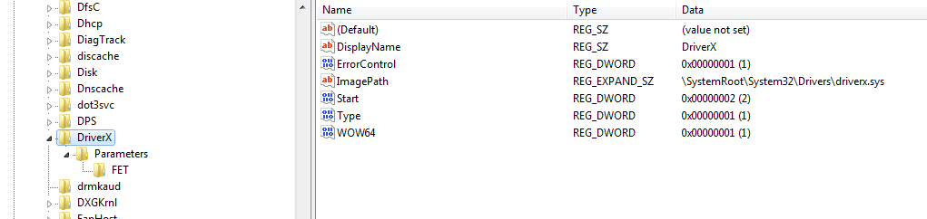

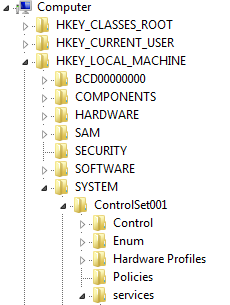

  • Here it is on my PC Win7/64. I deleted all references/Keys to DriverX using RegEdit.  Jens-Michael Gross - you'll be missed!
    Then under services... Delete it!
    Now under Software... Delete DriverX there too.

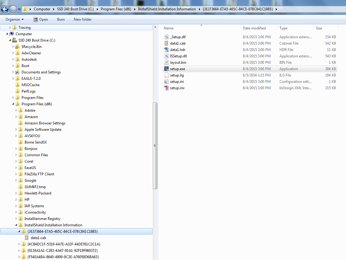

    And since the setup.exe file didn't work to uninstall from Programs and Features in the Windows Control Panel, I deleted this directory too. Not sure if needed, but it is gone from my program list now.
    Hope this helps ;) Freezing and Bluescreen free for 3 days now! Everything is running better actually.
