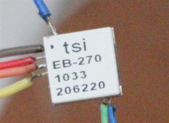

    edit: also can you give us specs on the gps? I have several and they need to have settings adjusted to communicate at different speeds. 9600bps is the default for all but 1.
    TSI EB-270
