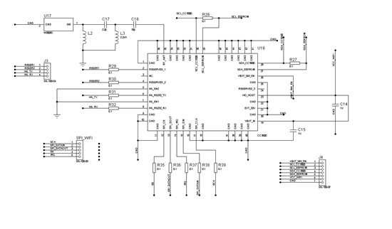

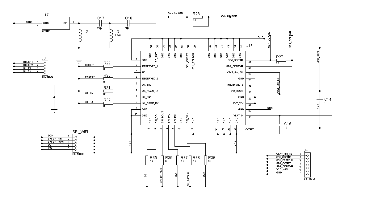

    Is this a custom board you developed?  If so, is the VCC_3.3V rails capable of supplying 1.0 A during start-up?  if the power isn't good when the CC3000 is enabled it won't start reliably.
    Have you used a scope to verify that the PWR_EN pin is going high and the SPI_IRQ isn't going low?
  • I haven't checked. Its my custom board. I am still stuck there. And it has to supply 1A as it does in 5739 EVM. I am giving supply through USB same like 5739 EVM board. Code stuck's in

    The USB can only supply 500mA (if supported, some USB ports only can supply 100mA).  The 1A requirement is for the 3.3V voltage regulator.  The regulator (with bypass caps) needs to be able to supply a 1.0A  transient roughly for 20uS.
    I am questioning this because I assume you are using a FR5739 Demo application unmodified except for the pin remapping.  If you send me your schematic I will have a look for you.
  • Yes i haven't changed much code  as only two pins are changed and i am using basic wifi application code. Have sent you my schematic. Let me know soon what is the problem.
    Thank you.

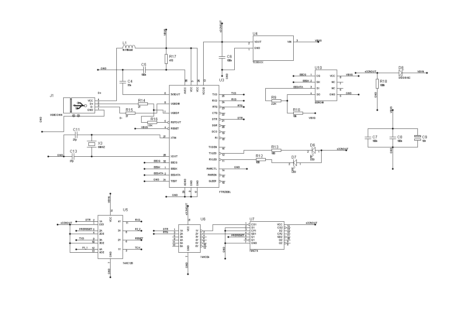

    Thanks for the schematic.  do you have another page that shows the 5V to 3.3V regulator?  Also, I don't see were VCC_HOST comes from; it only appears to be connected to VIO.

  • First, I still don't see the 5V to 3.3V regulation section in the schematic.  What is the Voltage regulator part#?

  • When the CC3000 first powers up (PWR_EN pin goes high) the CC3000 forces its IRQ pin low to indicate to the HOST processor that it has powered up and booted OK.  Therefore, I suggest it hasn't powered up OK.  Can you find out what the part# is?
  • Does this CC3000 has external supply of 3.3V rather than USB supply? If it has external so only my device is not starting and of that external supply device you asking me part number?
  • I'm sorry, I don't understand your comment.  What I am asking for is the part-number of the 5V to 3.3V Voltage regulator because if this part is inadequate than the CC3000 will not start correctly.

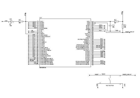

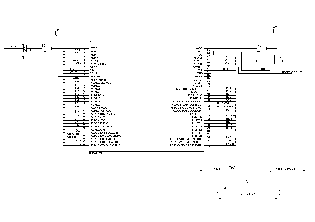

  • Hello schneiderham,
    I had a problem with cc3000 chip wifi when I tried to communicate between msp430f249 and cc3000. As a result,
    it stuck forever at  LINE 1. I think that it may be relative to voltage regulator 5to3 V. I will send to you my schematic and datasheet of this voltage regulator 5to3 V 4265.tc55microchi[p.pdf. Hopely, you can help me as soon as possible. Thank you so much!
