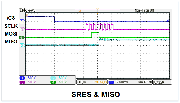

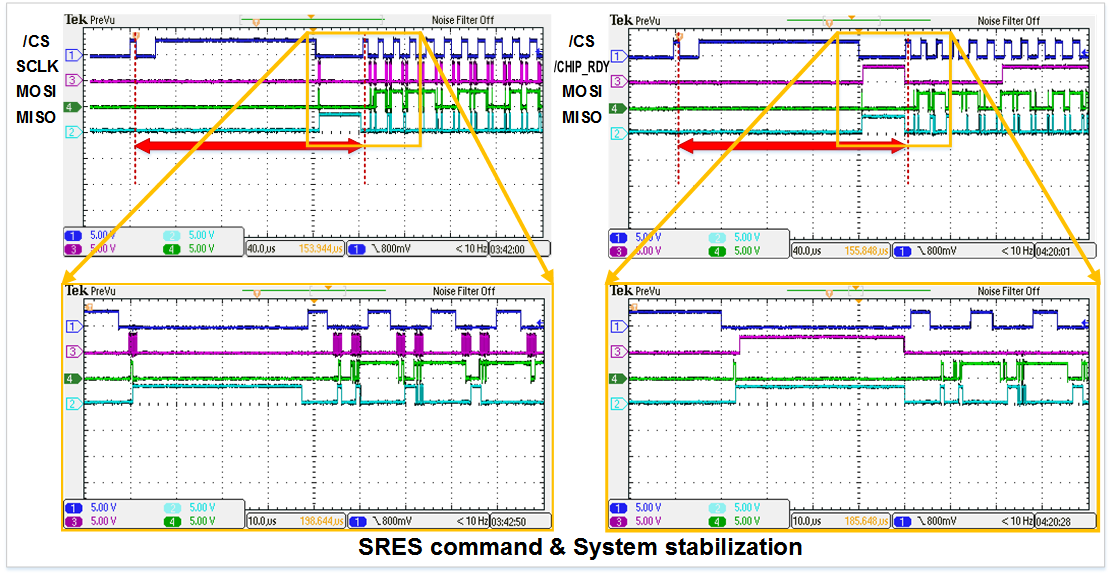

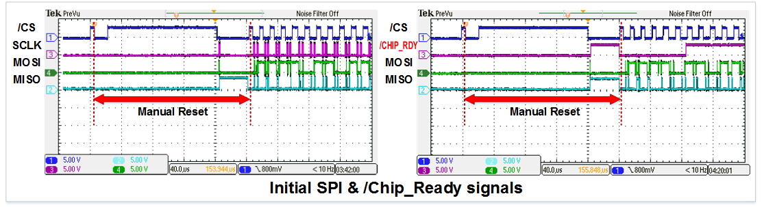

  • I captured the Ez430-RF2500’s initialize process for reference.
    1. /CS H → L
    2. Delay 15us
    3. /CS L → H
    4. Delay 140us
    5. /CS H → L
    6. Delay 2.2us
    7. Send SRES(0x30) to MOSI
    8. Until MISO goes Low or Delay 40us (> 37us)
    9. /CS L → H
    I ignore the datasheet's procedure and try to make the same signal as the Ez430-RF2500.
    I think the key points are just 5ms time delay for POR, and Manual reset instead of Automatic POR.
    (All of the sample codes Which I'd seen on TI or other web sites are using the Manual Reset)
    If the MISO signal check routine is complex to implement, then just use SPI interface & time delay as I mentioned upper descriptions.
    After the manual reset is success, then check a write and read test with PKTLEN(0x06) register.
    If these Initialization is correctly done, reduce unnecessary time by repeated operational test.
    (The first SRES command after power-on is operated as manual reset only,
     but the next SRES command just reset immediately.
     So, the timing delay which MISO goes low is 0 at the no power down situation. be careful)

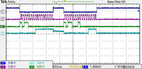

    Notice
    If you use the PART_NUM and VERSION registers, then these makes some troubles.
    I don't know why the /CHIP_RDY goes HIGH and the MISO level is ambiguous.
    So I try to check the operation by write and read a PKTLEN(0x06) registers.
    (It's shown the method on the Simpliciti's HAL code.)
