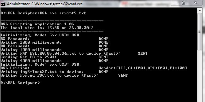

Hello everybody,
i have a question to the BSL_Scripter.exe Tool provided by TI in the file slau319a.zip, escpessialy to the USB-BSL. I want to understand some commands in the file '\slau319a\BSL_Files\BSL Scripter\Demo Scripts\5529_Application_Download\script.txt'.
This is the content:
MODE 5xx USB
// to erase device, should fail
RX_PASSWORD erase_pass.txt
DELAY 1000
// delay for mass erase
RX_PASSWORD ff_pass.txt
RX_DATA_BLOCK_FAST RAM_BSL.00.05.04.34.txt
SET_PC 0x2504
DELAY 3000
// The USB BSL is now in RAM, and is started
// We must now re-initialize communication
MODE 5xx USB
// Now we simply demo the use of the supported functions
RX_DATA_BLOCK_FAST 5529_LED_BLINK.txt
TX_DATA_BLOCK 0x8000 0x100 Data_Read_1.txt
CRC_CHECK 0x8000 0x10 0xCFB8
ERASE_SEGMENT 0x8000
TX_DATA_BLOCK 0x8000 0x100 Data_Read_2.txt
CRC_CHECK 0x8000 0x100 0x5B2F
TX_BSL_VERSION
SET_PC 0x8000
Now my questions:
#1: why is the PC set to 0x2504 after loading the RAM_BSL (SET_PC 0x2504)? How do i know this address?
#2: why is the PC set to 0x8000 after loading the application (SET_PC 0x8000) How do i know this address?
On the bottom of the wiki-page http://processors.wiki.ti.com/index.php/BSL_(MSP430) it is explained that this command resets the device after the Firmwaredownload and start the application, but this is only valid for the 5529_LED_BLINK example.
i tried the same method for my own Test-application (Olimex5510STK_Led_slow.

txt, see attachment) but it didn't worked. Why?

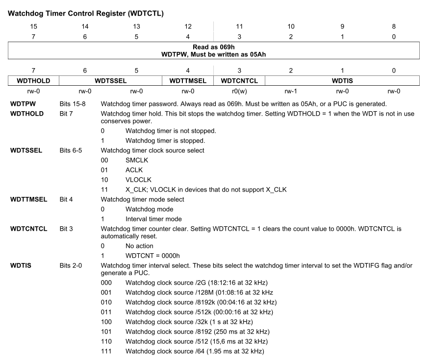

@015C
00 00
q
my question: why does this reset the controller and start the previous loaded application without disconnecting/reconnecting the USB cable? what is at address 0x015C?

    #3 You could use the BSL_Scripter Tool, that's a CLI tool supporting BSL core commands.
    the 0x15C is basically a watchdog register:
    and per default the access to the register is password protected:
    You can also try this, but if i not remember, in the case with the other customer i mentioned above, the only solution is to use the software BOR above.
    Hope this helps.
    It's a kludge. It 'uploads' something to the watchdog register. Since this 'something' does not contain the proper password, the MSP will undergo a PUC (and set the WTDIFG bit) as soon as the BSL tries to execute the write order given to it by the scripter program. After a PUC, the MSP will load the program entry point from 0xfffe and start execution where this address points to.
    However, a PUC won't reset everything to power-on-condition. So if the BSL has made some changes before like activating the timer, this won't be undone by a PUC. (see users guide for which registers are initialized on PUC and which aren't. Timer registers aren't.)
  • Hi  and , I think posting my problem here will make it easier to get your support than starting a new thread.
    When I first failed to load my txt into msp430 memory with bsl_scripter, I thought that was because of some comprehensive mistakes in script.txt, such as wrong command, address or order of commands). Why do I think so:
    _Successful enter to BSL via hardware button (visible HID device,PID/VID as described in TI's documentation).
    _The BSL_Scripter command window showed this:
    But the led did not blink as expected, instead my f5527 still worked with the old code. I've asked Mr.Guenther (an active member of E2E Community) and had his answer:
    Guenther Klenner said:
    Hi Cao,
    According to the screen dump you have no USB BSL connection. You can see this by RX Password. At least one must respond FAIL to start memory erasure. Most likely both fail.
    Check on your device manager if you see MSP430 connected in boot mode (PID/VID).
    However, the microcontroller has already entered BSL for sure:
    So what's the problem? Could you help me with this mess? To be more detailed, I've tried enter BSL with software and hardware method.
