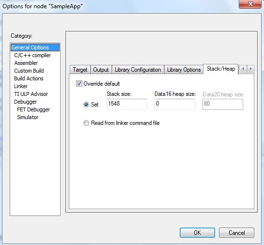

  • Dear Kiran,
    When I check the options as shown above, I have seen Data 16 heap size is set to zero by default.  Change this to 64 or 128 and try it out please. This might resolve your error. Please let me know regarding the same.
    Vidya.

  • kiran nayak said:
    if i want to make DATA_16 range 1k
    Normally, it should be as large as it requires.
    You must differentiate between the DATA_16 and the DATA_16 heap. The heap is a placeholder which reserves space for use with malloc or dynamic object generation (when using C++ classes) or such. If you don't need dynamic heapspace allocation, it can be left to 0.
    The 'stack size' also just places a big placeholder into the ram segment. It does not influence at all how much space the stack will take or not (a chane of this settign won't change a single bit in the generated binary). If you call a function, the stack will grow, whether you have reserved that much or not. Same for local variables in a function. THis settign jsut forces a linker error if there isn't that much memory left when all other objects have been placed. SO you might want to reduce this setting to a value that is suitable for your application (and some reserve space).
    If you don't use printf and don't have large amounts local variables in your functions, some hundred bytes are enough.
    You might want to set the stack size to 0 bytes or whatever teh linekr will allow as minimum, so the linker will link the project and generate a map file (enable map file generation in the linker settings). Then you can look at the map file to determine what takes all the memory in your ram segment.
