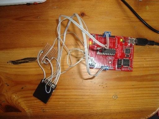

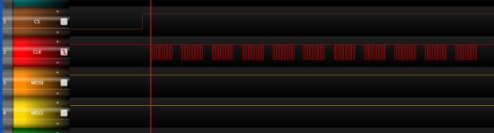

at the moment I am trying to interface a SD Card with the MSP430G2231.
Therefore I´m using the MMC library functions provided by TI.
Now the problem is after sending the Go_Idle command to the SD Card it always responses
with a TIMEOUT_ERROR and I really can´t imagine why.
Maybe a bit more precise explanation :
First I raise Chip select and send some dummy bytes to the sd card for about 80 clock cycles.
Then I pull CS low and send the Go_Idle command to the sd. Afterwards I try to read the response of the
sd card and that´s where it answers with the timeout error.
The voltage levels are perfectly correct ( I just measured it).
But I don´t know if the MSP430 clocks properly (can´t measure it because I have no scope).
So here´s my port initialization :
 WDTCTL = WDTPW + WDTHOLD;             // Stop watchdog timer
          P1OUT =  0x10;                        // P1.4 set, else reset
          P1DIR = 0x01;                         // P1.0 output, else input
          P1DIR |= SD_CS;                           // Set P1.4 to output direction Chip Select
          P1DIR |= SPI_SCLK;                        // Set P1.5 to output direction Master Clock
          P1DIR |= SPI_SDO;                         // Set P1.6 to output direction Data Output
          USICTL0 |= USIPE7 +  USIPE6 + USIPE5 + USIMST + USIOE; // Port, SPI master
          USICKCTL = USIDIV_4 + USISSEL_2 + USICKPL;      // /16 SMCLK
          USICTL0 &= ~USISWRST;                 // USI released for operation
          USISRL = 0x00;
          for (i = 0xFFF; i > 0; i--);          // Time for slave to ready
          USICNT = 1;                           // init-load counter
Hope somebody could help me.
Regards, Max
    This sets the USI to send one bit with SMCLK/16. However, the loop itself is faster than 16 MCLK (and therefore most likely SMCLK too) cycles.
    So you program the USI for another bit before it has sent the first bit, probably resettign the baudrate divider and nothing is ever sent. Jsu ta guess.
    You should do
    for(i=10;i>0;i--){ // send 80 bits
     USICNT = 8; // clears USIIFG, as long as USIIFGCC is clear
     while(USICTL1& USIIFG); // wait for 8 bits sent
    Also, it might be necessary to set USICKPL. IIRC I had to do it on the USCI module (MSP430F1611) for SD card access for correct clock polarity (clock is inactive high and active low)

  • MaxE said:
    USICKCTL = USISSEL_2 + USICKPL +USIDIV_4;
    Should do. IIRC, the clock mus tbe low-active, so CKPL needs to be set.
    MaxE said:
    the SD_Init() returns the Init_Error all the time.
    Sure? How do you know? You don't check for status in this loop.
    What library do you use? I only know the MMC libary (slaa281b), which more or less also applies to CD cards.
    However, a general quesiton: what size is your SD card? Newer cards, usually SDHC/SDXC cards, Especially those which claim to be 'high speed' do not implement the serial/SPI protocol anymore.
    Cards above 4GB (or sometimes even 2GB types), require a larger blocksize than the original 512 bytes and have a completely different configuration structure. Along with changing the internal organization, most manufacturers have also dropped the serial support.
    That SD_GOIDLE returns a timeout may indicate that your card doesn't support serial mode at all.
    Of course there's still a chance of a hardware problem. Does the card support the MSPs supply voltage? If they have separate supplies, what about the logic levels?

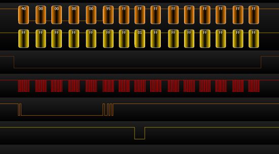

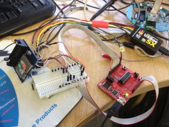

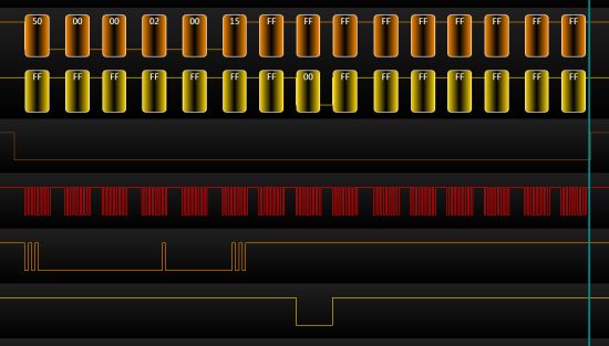

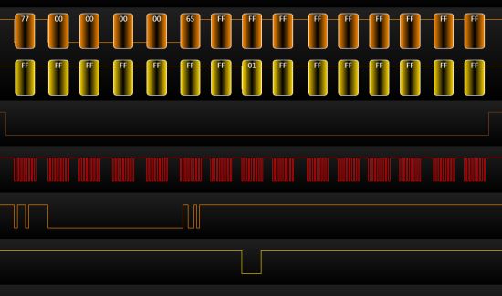

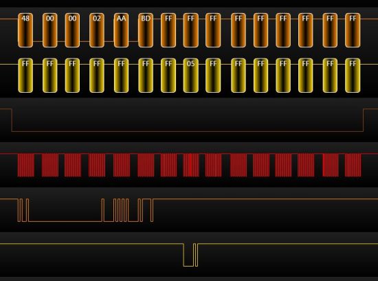

  • Hi Max,
    You are using CMD1 to initialise an SD card. Not all SD cards support the MMC method of initialisation, and it is not recommended even if they do.
    If its an SD card you should be using CMD0 >> CMD8 >> ACMD41.
    I'll post a step through of the ACMD process on Monday.... If you can't wait download the physical spec (link above) then read section 7 SPI.
    @Jean: If you were doing the same, then this is why your SDHC cards were not responding. SPI mode for these cards will not proceed without going down the correct route.
    Mark.

  • Not the most elegant code, but it works on a launch pad with an MSP430G2452 (so code should also work with a MSP430G2231 as they both have the same USI):
    SPI clock comes out a ~ 30kHz with this setup. I'll post some screen shots of the SPI transfers when I get home.

  • Here is the setup:
    The whole process:
    88 clocks: (should only need 80, but more is fine)
    CMD0
    CMD8
    CMD58
    CMD55
    ACMD41 (response 1)
    ACMD41 (response 0 - ready)
    CMD16
    Points to note:
    - Response from the card is not always the first byte after the transaction (as you can see mine was the second byte).
    - The process above took ~200ms.
    - SPI clock was 62 kHz not 30 mentioned in previous post.
    - Now that initialisation is complete, SPI clock can be boosted, I think the max speed is card dependant - not too sure on this one.

  • Hi Max,
    If you look at my screen shots above you will see that the first response I get is always 0xFF as well. I don't get the real response until the second byte.
    I'm guessing that if you step through with the debugger then this gives the SD card enough time to send the real response out with the first byte.
    Try doing this (you will have to write the functions):
    send_CMD0();                    // send out the command bytes:  0x40 0x00 0x00 0x00 0x00 0x95
    response1 = send_1_byte(0xFF);  // send out 0xFF and get first response
    response2 = send_1_byte(0xFF);  // send out 0xFF and get 2nd response
    response3 = send_1_byte(0xFF);  // send out 0xFF and get 3rd response
    0x01 will be in response1, 2, or 3.

  • 1. I use the TI LaunchPad MSP-EXP430G2 Rev. 1.4 with the MSP430G2231.
    2. As development environment I use CCS v5.2.1.00018
    Mark, I am sure your code would work fine, the issue probably is hardware dependent.
    The SD card works fine when I plug it in the card reader of my laptop.
    The only problem I can imagine is that it´s current supply isn´t sufficient via the J6 pins. Could that be ??
    To try out another card I have to change my setup which I will do within the next few days.
    Here a picture to get an idea of my setup
    To connect with the microsd I use an microsd adapter which I soldered to the wires.
