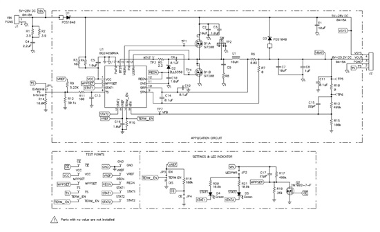

  • Hi Marco
    Here is the schematic for the BQ and also for the parts connected to it. There is a LDO and MSP430F2013. I am confused on which ground to use for the LDO and MSP since there is PNGD and AGND.

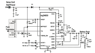

  • Marcos
    Here is the other parts.
    I counted two grounds, one PGND and one earthing ground.
    for me it seems that the two grounds are the same (If I analysed the schematics correctly):

  • Marco
    The only point the ground is connected is under BQ, there is a recommendation on the user guide to separet the ground , analog and digital.

  • 1. It is critical that the exposed thermal pad on the backside of the bq24650 package be soldered to the
    PCB ground. Ensure that sufficient thermal vias are right underneath the IC, connecting to the ground
    plane on the other layers.
    That means that it is critical to solder the thermal pad directly onto the PCB ground. (not ground in meanings of voltage).
    At least it has to be connected to ground :-)
    2. The control stage and the power stage must be routed separately. At each layer, the signal ground and
    the power ground are connected only at the thermal pad.
    This means that the two grounds have to be connected together at the thermal pad.
    That is also what the datasheet example shows (thermal pad below the IC)
    I would connect all other devices (MSP430 and others) to the termal ground now, as it is the only common GND in both cases.

  • Marco
    So lets call Solar (-) lead and Battery (-), would be considered GND , correct ? Then MSP and LDO would be tight to that point, correct ?
    only if you connect to the termal pad the shortest way (directly and with a real good soldered connection). There has to be a reason why there are two grounds, both drawn together at the termal pad. From my point of view you will have to try it out and make your own measurements and experiences with your prototype .
