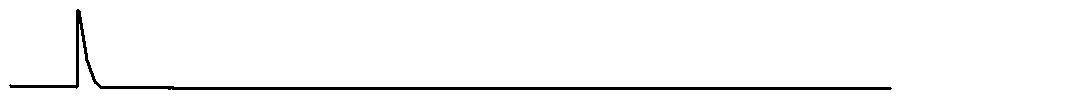

    When I posted this question I thought there is no DC bias at XIN and XOUT because I checked 0V on those two pins with oscilloscope. But today I found another thing, those pins are not simply 0V. When I touch the probe of oscilloscope on the pin, those two pins are few micro-seconds high then fell down. (This phenomenon is found at XIN and XOUT pin only. And the waveform like below was appeared in my oscilloscope every time when I touched one of those two pins with probe.)
    The peak voltage is 1~2V. (3.6V battery is connected to my board)
    I can’t understand the meaning. I guess that DC bias is added to those pins but It is impossible to maintain the voltage by some reason (current shortage or …). Is it correct? If not, please let me know the reason.

    About the strange peak on XIN: it may be that there is some charge building up at the pin by crosstalk or leakage currents, which is discharged as soon as the probe is connected through the probe input impedance. Note that  a crystal is a capacitor of its own.
