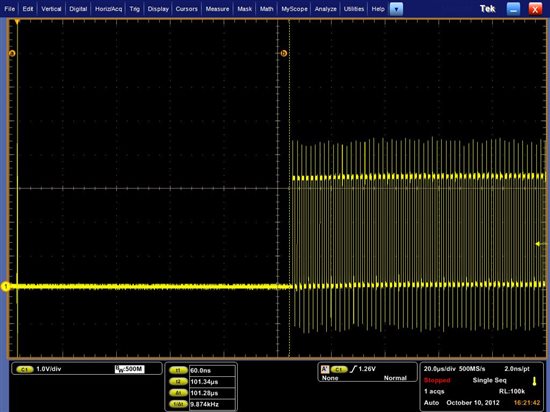

When working with timers in the MSP430FR5739 I can detect a certain delay (not constant and always in the range of µs) when switching on the signal and outputing the capture/compare unit output. I will expect having a delay of some nanoseconds but µs are a good bunch of cycles in between.
Does anyone know where does this delay come from? Is it possible to avoid it?

I attach the result that I get in the Osci when meassuring the output on the pin P1.1:
 As shown in the Osci the delay between the port is switched to timer output mode (bis.b #BIT1,&P1SEL0 ) till we get the timer output is around 100µs. If we are working at
24MHz, these are 2400 cycles in between.

    I looked into this and found indeed the TimerA0 will not start counting right away if ACLK is used -- where ACLK is setup to be identical to SMCLK. When ACLK is used, TA0R stays =0000 for tens to hundreds clocks and then start to count. When the identical SMCLK is used instead, TA0R starts to count right away as expected.

    There is no bug here.  The delay you are observing is the result of the MCU operating as designed.
    After reset, ACLK is sourced from XT1.  (Actually, because XT1 is not oscillating after reset, VLO stands in for XT1, but that's not critical to this discussion.)  When you write to CSCTL2 to change ACLK from XT1 to DCO, the clock module takes quite a long time to make that switchover.  Meanwhile you keep executing instructions while ACLK is stalled.  In your oscilloscope pictures, it's this switchover delay that you are observing.  See section 3.2.8 of the FRxx manual for an explanation of the switchover (and why it takes so long in this case).
    After reset, SMCLK is sourced from the DCO.  In your configuration, you don't switch SMCLK to another source, so there is no switchover delay.
