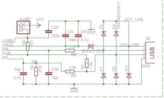

I created a MSP430F5510 Experimenter Board for testing my applications.
There is an USB module:
Jumper isn't used.
I had a problem to run USB CDC example and in other thread (http://e2e.ti.com/support/microcontrollers/msp43016-bit_ultra-low_power_mcus/f/166/t/201314.aspx) I got suggestion:
TonyKao said:
There is an errata for the MSP430F5510 LDO where sometimes the device can fail to detect the 5V VBUS; unfortunately the "fix" in the USB package involves cycling the LDO, which is catastrophic for bus-powered devices relying on the LDO as it means an endless reset loop. If this is the case try commenting out USBPWRCTL = 0; in USB_Init().
After it it's fine but when USB is connected before MSP is turning on MCU doesn't start. Is it my design mistake or maybe is it a result of this "bug"?
I can live with that but I would like to know how to avoid this issue in the future projects if it's possible.
