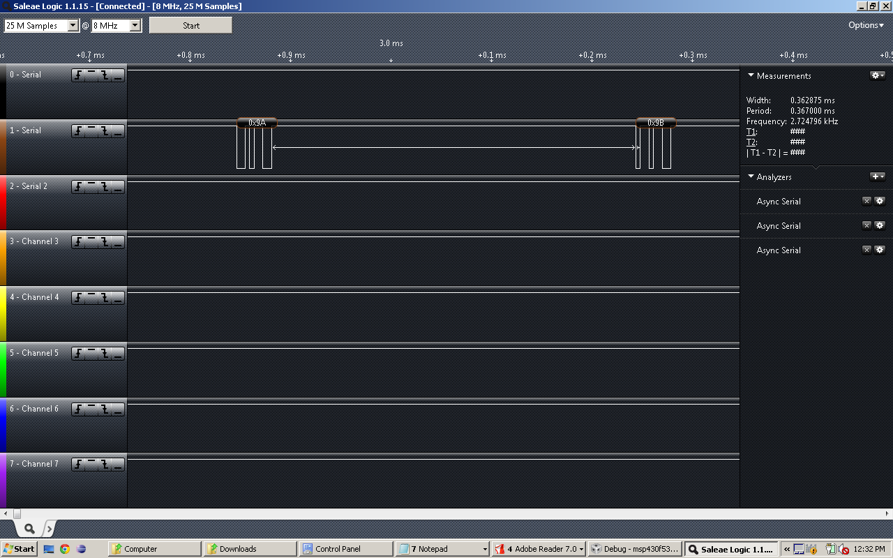

I'm programming an MSP430F5325, using Code Composer Studio and interfacing by way of the programming half of a Launchpad board that is connected to the spy-by-wire pins.  My goal is simply to send UART data out the UCA0TXD line at a reasonably fast baud rate like 115K.  While I'm basically having success, I'm finding that there seems to be a time lag of about .3 ms between each byte, and I haven't spotted in the docs any explanation about why this is or whether it's possible to eliminate it.  The following output from my logic analyzer illustrates what's happening:
Here's the basic code I've been using:

  • Hi Christopher,
    I see a couple of issues in your example:
    - You seem to be clearing SELM when you write UCSCTL4 (this is probably the main cause of the behavior you saw)
    - Initialize the PMM if you are running >8Mhz
    - It's recommended to add a delay and clear clock fault flags when initializing the UCS
    You can find drivers and examples of UCS/PMM initalization in DriverLib, CoreLibraries or the C examples
    Luis R
  • Awesome, thanks for the speedy resolution (not sure how I overlooked those SELM flags...)
