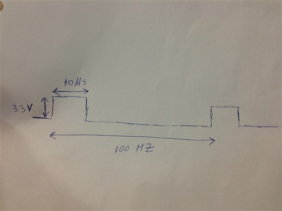

  • Hello Jens-Michael,
    sorry for the typo.  The frequency of my square wave is 100 HZ.
    I have attached a picture to illustrate what I need.  I am working with a transducer and have designed a transmitter/receiver hardware module to basically excite this transducer and receive the echo signals.  My transducer works best with the attached square-wave signal.  Therefore, I need to generate a signal that has the following features:
    3.3 V in amplitude
    frequency:  100 Hz
    Time that the signal is HIGH:  10 Microseconds
    So, you mean that it is hard to generate a signal with this specification?  I'm very new to MSP430 units and really appreciate your help.
    Thank you very much
    Arash
  • Arash Taheri said:
    3.3 V in amplitude
    frequency:  100 Hz
    No, it's rather simple. You need VCC=3.3V (for the output amplitude), a 1MHz clock (1µs tick) and a timerA module (all MSPs have at least one).
    Setup:
    source TimerA with 1MHz clock, up mode.
    CCR0 configured for a cycle of 10000 clock ticks (CCR0=9999)
    CCR1 configured for capture mode, output mode reset/set. trigger on tick 10 (CCR1=10).
    port pin connected with TA.1 configured for module, output direction.
    That's all. Now the hardware will generate a fine 100Hz signal with 0.1% duty cycle withouzt any further software intervention.
