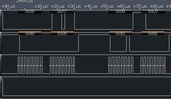

USART - SP Mode -- U0RXBUF does not shift in bit-0
Other Parts Discussed in Thread: MSP430AFE253
uC: MSP430AFE253
Slave: MPL115A1 (Freescale Barometric Pressure Cell)
Assumption: The SPI mode of communications is the same for TX & RX for the slave, i.e. one should not have to change CKPH and CKPL registers of the MSP to perform a proper input shift register phase.
Issue:
SPI sends slave correct READ/WRITE address according to logic analyzer, the response from the slave reads the same as a Freescale demo board according to the logic analyzer. But, it appears that the MSPs U0RXBUF does not have the bit-0 shifted in.
Example:
Logic analyzer reads two registers in sequence as 0x77 and 0x40 (MISO).
MSP U0RXBUF reads the following, 0x3B and 0x20.
0x77 = 111 0111
0x3B = 111 011 < Missing last bit
Attached Screen Shot (data not same as above example, first line MISO, second MOSI, CLOCK, SC:
0x40 = 100 0000
0x20 = 100 000 < Missing last bit

  • Are you sure your clock phase is right? Being off by one bit is usually a result of using the wrong clock polarity or phase. However, your selection seems to be correct.
    But I notice you clear SWRST right before configuring the USART. This is wrong. UCSWRST needs to be set while configuring the USART. See init sequence in 19.2.1 USART initialization and reset in the users guide.
    It's possible that since SWRST has been cleared, your phase selection isn't accepted and the USART runs with the configuration as it was when SWRST was set (the state machine has been started and already adopted part of the current configuration, so later changes may or may not apply)
  • Thanks for the help,
    Yep, I dyslexic'ed  out !  Your are correct, I was setting SWRST incorrect!  The funny thing, I also have RS-232 communications where SWRST is set correct.  I commented out the RS-232 to set-up the SPI before going back to the RS-232 in combination with the SPI.  Thus, the answer was in front of me the whole time.
    As an aside, I had to comment out where I cleared the U0RXBUF in the first switch statement, and uncomment out the DO/WHILE statement, set back the shift to 8, and some other minor changes.  Back in the saddle again!
