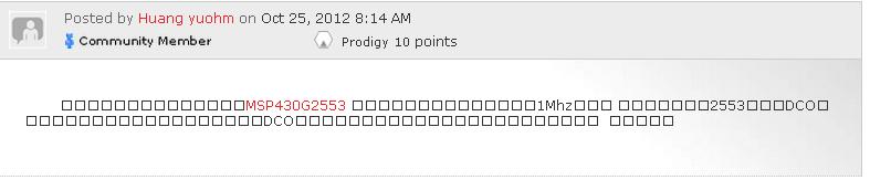

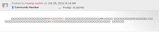

        首先感谢您的帮助。本人在使用MSP430G2553 的时候,需要用到一个高精度的1Mhz以上的 时钟信号。发现2553的内部DCO误差太大,想通过计算外部晶振脉宽来校准DCO,请问可以实现吗?如何实现?或者有更好的建议?  在此谢过。

  • Gaston_Melo_Arg said:
    this is what I see:
    If you ionstall the chinese font, you'll see nice, beautiful chinese letters. Howeve,r it doesn't help understanding what this thread is about. I don't talk chinese.
    Maybe Old Cow Yellow can help here.
