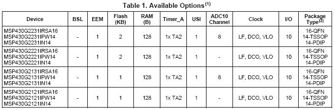

    If you don't need breakpoints debugging, flash can be updated with BSL. Just backup info memory segment (if it is used), because some BSL versions on MSP430x2xx devices with mass erase will also erase info segment.
    There is info table in MSP430x2xx device datasheet about (non)existing BSL (Table 1. - Avaiable options). If BSL is marked in table, than it is exist. For example...
    If you already used BSL on other devices than you have software/hardware tool for it.
    Flashing is explained (with open source code) in TI documents...
