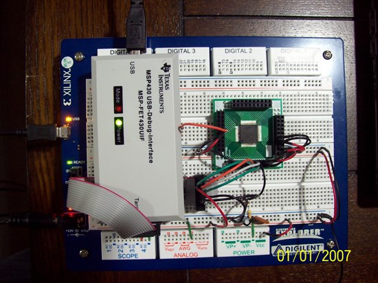

I'm having a bit of trouble and I'm hoping someone can point me in the right direction..

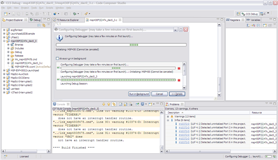

I'm trying to program a MSP430F478 with the DAC demo and while I believe the FET is connecting to CCS correctly, I consistently receive the error below:
My system specs are:
  • Dell Latitude D630 laptop
  • Windows XP SP3
  • CCS 5.2.1.00018
  • MSP430F478 soldered to a proto-board
The (summarized) steps I have taken over the past two days are thus:
  1. Uninstalled CCS 4.x (installed two years ago when I got a LaunchPad, which worked great but didn't have a DAC)
  2. Connected MSP-FET430UIF -- This created two entries in Device Manager, one listed under Ports as "MSP-FET430UIF - VCP", and another non-working entry with an <!> (I don't remember the category, but it was not a HID entry)
  3. Disconnected FET
  4. Installed CCS 5.2.1.00018, with only MSP430 items and using the Code Limited license
  5. Soldered and wired my MSP430F478 on the Digilent Electronics Explorer board
  6. Opened CCS and connected the FET via USB
  7. Opened the "msp430F(G)47x_dac0_3" workspace in CCS
  8. Hit "Debug" and after waiting a while, nothing happened
  9. Closed CCS
  10. [Repeat multiple times, connecting and disconnecting the FET with no change]
  11. Researched FET connection problems and found it may be the driver
  12. Tried to update driver thru Device Manager... "no better driver could be found"
  13. I didn't want to install IAR and figured CCS should come with the driver but I couldn't find a way to check if CCS could even see the FET
  14. Researched CCS and FET more...
  15. At this point I noticed the FET (V1.4a, S/N: 1208006352) would blink red-red-red (fast) then stay green -- I was confused because I thought that V1.4+ had the updated firmware but the LEDs didn't indicate this..
  16. By repetition and trial and error, I continued to dis/connect the FET and try debugging the demo and restarting CCS with no progress -- also I tried changing the wiring and having the target powered alternately by the Digilent and by the FET
  17. I uninstalled the non-working entry from Device Manager thinking Windows would try to re-install the device when I reconnected the FET; it didn't.
  18. Researched CCS and FET more...
  19. I happened to change the USB port the FET was connected to (from the side USB to the rear USB)
  20. I closed CCS, dis/connected the FET, restarted CCS
  21. I hit "Debug" and CCS displayed the "... firmware update is required..." dialog! OH, HAPPY DAY!!
  22. I clicked "Update" and CCS began flashing the FET
  23. After a few minutes, the console window displayed the message "... manual restart required...", so I dis/connected the FET -- no love
  24. Researched more and closed CCS (I assumed it crashed)
  25. Dis/connected the FET (now only the green LED lights) and restarted CCS
  26. I checked the Device Manager and now the FET is listed under Ports as "MSP-FET430UIF - CDC"
  27. Hit "Debug" and ... ... ... no love -- now receiving the error shown above
  28. [Repeat consistently ad infinitum]

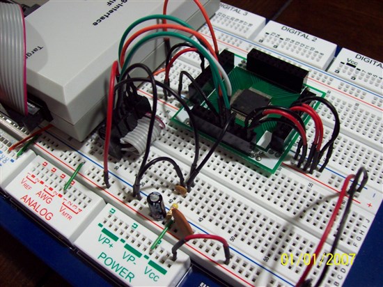

  29. Double-check all wiring connections FET<->MSP430F478<->Digilent and they appear to be correct.. it doesn't seem to matter if the target is powered by the Digilent board or the FET
My documentation references have been:
Questions:
  1. Can someone please offer insight into the source of the "Could not initialize device interface" error and how to fix it?
  2. I'm about to upgrade to a Lenovo laptop with Win8 64 Pro, will this cause any issues I should know up-front?
  3. How can I ensure I didn't screw-up the soldering? (I've used a microscope to check, and all the leads look good..)
  4. I've discovered that I'm using a 1nF pull-down capacitor instead of a 10nF, is this a problem? (I can fix it, if it is)
  5. I've tried using the Elprotronic Lite FET-Pro430 Flash Programmer software mentioned in other posts to read my FET firmware version, but the software constantly crashes; should I care, or just by virtue of the green LED trust that the FET's working correctly?
  6. I was told by another grad student to connect all the Avss/Avcc to the Dvss/Dvcc and all grounds together - then I was told by my professor not to do that. The MSP430x4xx Family User Guide gives guidance how to connect "unused pins," but doesn't distinguish what "unused" means - if I'm only intending to use the DAC and UART, what pins are "unused" and how should I connect them?
Many, many thanks to those brave souls who read this entire post, I hope this is a relatively easy fix and I can get to the fun part of actually programming soon! :D

  • 1) The error seems to indicate that the software cannot establish a connection to the FET.
    In the past, this has been often tracked down to 3rd party software that was hijacking the virtual COM port as soon as it appears, such as mobile devices (smartphone) comm software or even mouse drivers.
    Sometimes this software is so badly written that it doesn't notice that the FET is no smartphone/mouse.
    2) past reports indicate that the driver isntallaiton may be shakey under Win8. 64 bit will surely increase the problem. Especially since the drivers areN't M$ signed for WIn8.
    3) Well, once you got it working, you know that the wirings are correct. X-ray inspection would require a workign sample for comparison :)
    4) If you're taling about the pull-down cap on RST, well, it is required for non-ideal power supplies (non-instantaneous voltage). The slower voltage rises, the larger it must be. Up to a certain point, it is not necessary at all. I use 100nF, but I don't use SBW (serial JTAG), where 2.2nF are the max.
    5) I never had the Elprotronic software crashing. It too indicates a driver or application conflict.
    6) If you don't use analog functions, you may connect AVCC/DVCC and AVSS/DVSS or even leave the analog supplie sopen (they are internally connected through clamp diodes).
    If you use analog functions, you should
    - connect AVCC to DVCC through a 10Ohm or 33Ohm resistor (smaller, if you use a DAC and need analog output current), and a 100nF ceramic/10µF Tantalum combo. This decouples the analog voltage from any digital ripples. (the clamp diode threshodl voltage is much higher than any ripples, the diode doesn't conduct at all in this case).
    - route AVSS and DVSS separately to the supply. This way, any supply return current from digital circutry (on DVSS GND) won't induct voltage ripples on the analog GND. Use the analog GND for any GND reference of external circuitry too. Here again, teh clamp diodes in teh MSp won't allow the two GNDs to drift too far apart but won't conduct on small rupples.
    This keeps your analog voltage references clean.
    Regarding 'unused' pins: the mainconcern with unused pins is the high input impedance of CMOS inputs that allows static voltage levels to build up on isolated pins and their stray capacity. The may even catch radio waves and oscillate. Aslo, if the input voltage is near the transition voltage of the input, internal cross-currents will flow (two opposite transistors are conducting in the input circuitry), causing increased power consumption. Therefore all pins wiht digital input capability should be turned into low output mode if not externally connected.

    1) Given that CCS found the FET and updated its firmware, doesn't that suggest that CCS can find it and there's no driver conflict? How would I determine if there's an interfering driver? Is there a way to make sure the FET was updated properly and there's not something wrong with it?

         - Could you clarify the arrangement of the resistor and capacitors between Avcc and Dvcc? I read it as the resistor and capacitors are in parallel with each other, and the group is in series between Avcc and Dvcc. Like: Avcc-----(ceramic // resistor // Tantalum)-----Dvcc
         - So, the Avss and Dvss ground traces are separate as they are routed back to the regulator ground pin, at which point they both connect to the same pin. Did I understand that correctly? Do I also understand that (if I was making a PCB) the analog ground would also be the ground pour around the rest of the board? Would I need capacitors between the analog and digital ground traces, or the analog pour and digital traces? I've never done this before, can you point me to a good resource for this info?
         - So, once I setup the ports correctly I won't have any "unused" pins, I won't receive the warnings in CCS, and won't have to worry about how to connect them?
    Yes and no. Maybe jsut after the update, the changed response of the FET causes the offending interfering software to hijack it. :)
    Maybe the update failed.
    What you can try: look into device manager for the MSPs COM port, then try to open this COM port with HyperTerm or another terminal program. You should get an error if the port is in use.
    I'm definitely no FET expert. I don't even use CCS or IAR, and the Elprotronic software never tried to update the firmware. So I cannot tell you what could have gone wrong or how to detect whether it is right. I'm sure there is an identification sequence of some sort, but I really don't know. Well, teh green LED should light up when you plug the FET into USB. That's all I can tell.
    But there are many other threads about FET problems. Maybe you'll find some info there.
    No, the resistor is between DVCC and AVCC and the caps are between AVCC and AVSS. A cap parallel to the resistor would short the resistor for transientes. Quite the opposite of what is required.
    No caps between analog and digital ground. Those caps would just forward the voltage ripple fo the digital gnd to the analog gnd. It would best to keep the two as far away as possible (at least don't put a single AGND trace on a DGND plane with only a small gap between). One can go as far as routing AGND on the top layer when the bottom layer is a GND plane, and include a gap on the gnd plane where the AGND trace is - to reduce stray capacitance. But in the very most cases this is pure overkill.
    Whether you use AGND or DGND as GND plane (if usign a GND plane at all) depends on applciation. Usually, it's better to have digital GND on the GND plane (or pour) as it carries the higher currents. Stretching it across a plane reduces crosstalk a bit. However, don't expect the current s in a GND plane to be evently distributed. They tend to flow where an opposite current flows on the other layer. Well, we noticed this effect when we modulated 30A for a laser. A GDN pour and a GND plane are also acting a bit different. Again, things like this depend on application and required precision and resolution.
