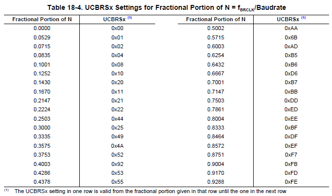

  • Hello Koyo,
    I think problem is  UCBRSx and UCBRFx.
    And ı think this is better
    UCA0CTL1 |= UCSSEL_2;
    UCA0CTL1 &=~UCSWRST;
  • Koyo Kegasa said:
    UCA0BR0 = 1 ; // 1 = 921600 baud = 14745600/1/16
    UCA0BR1 = 0;
    // UCBRSx = 0x00 upper 8bit, UCBRFx = 0x0 4bit, UCOS16 = 0x1 4bit
    UCA0MCTLW = 0x0001 ;
    Following the algorithm named "Baudrate settings quick set up" in chapter 18.3.10 Setting a Baud Rate, I would set: 2. UCOS16 = 0; UCA0BRW = 16u; 4. UCA0MCTLW = 0u; Regards, Peppe
