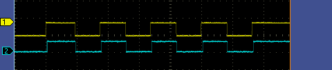

First i have a problem with a simple program. (I have the same in a bigger code, so first i tried it in a smaller one..)
First code with if:
#include <msp430G2153.h>
void main(void){
	WDTCTL = WDTPW | WDTHOLD;
	BCSCTL1 = CALBC1_16MHZ;
	DCOCTL = CALDCO_16MHZ;
	P1DIR |= BIT0;
	P1SEL = 0x00;
	while(1){
		if(P1IN & BIT1)
			P1OUT |=BIT0;
		else
			P1OUT &= ~BIT0;
The picture from osc.:
Second code with an interrupt.
#pragma vector=PORT1_VECTOR
__interrupt void Port_1(void)
	P1OUT ^= BIT0;
	P1IFG &= ~BIT2;
	P1IES ^= BIT2;
void main(void){
	P1DIR |= BIT0;
	P1SEL = 0x00;
	P1IFG &= ~BIT2;
	P1IE |= BIT2;
	_enable_interrupts ();
	while(1){
The picture from the osc.:
My Question: Why is there a little interrupt after the low-high edge?

  • I suspect you're tripping over the conditions in section 8.2.7.2 in the User Guide. Summary of that table seems to be that if you request "A->B edge" in the IES and the pin is already at "B", you might get an immediate (stray-ish) interrupt.
    The indicated fix would be to set (change) the IES Before clearing the IFG.
    Out of context, I'm not sure what those CCS messages are telling you.
    thank you for your answer, but the problem is unfortunately not solves.
    When i change the settings of ifg like this:
    	P1OUT ^= BIT0;
    	P1IES ^= BIT2;
    	P1IFG &= ~BIT2;
    void main(void){
    	P1DIR |= BIT0;
    	P1SEL = 0x00;
    	P1IFG &= ~BIT2;
    	P1IE |= BIT2;
    	while(1){
    Now first i change the ies, then i delete the ifg.
    But then i have the following signal:
  • hi,
    by writing this statement
    P1IES ^= BIT2;
    you are changing the edge on which the interrupt occurs every time the ISR is called.
    in other words, by a single button press you are triggering 2 interrupts '
    1. one on high- to low transition
    2. the other on low-to high transition
