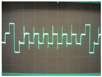

  • Dear Sir,
    Following are the images I have added to show the problem.
    First image show less noise on the COMS when the less segments are ON.
    So how to eleminate this problem.
    Thanks in advance.
    Somnath Barge

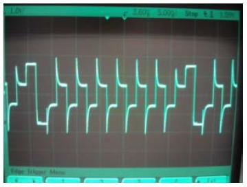

  • Dear Sir,
    In my previous post I have shown the image for less segments ON. Now following is the
    image when we increse the ON segments the noise on the COMS is increasing. This
    makes the OFF segments dimmed ON.
    How to avoid such noise on the COMS.
    See the IMage
    I have used internal biasing(1/3) . I tried by changing the contrast voltage by using the VLCD
     LCDCVCTL = LCDCPEN | VLCD_2_96 ;//| LCD2B_L;
    but the problem is not solved.
    Thanks in advance
  • I see the problem. Well, this isn't noise, this at first glance looks like some unexpected overshooting when switching the multiplex phases.
    I have no idea where it comes from but it shouldn't be there at all. Most surprising are the negative peaks after the large rectangular signal which cannot be explained by overshooting at all. Also, there is some charge time (no keen edge).
    What is your ground reference for the scope shots? Sometimes a wrongly chosen GND point lets us see things that aren't there ate all - or are different than we see them, which makes debugging difficult.
    If I had to make a guess, I'd say it looks like a diode (or transistor) on the switching stage that doesn't block fast enough or has a huge capacitance, so it lets a peak of maximum votage through when voltages are switched, depending on total load. What is your VCC? Did you forget some required blocking caps on the voltage generation? Just guesses.
  • Dear sir,
    I have used internal biasing to generate the voltages. So as per their recomdation used the 4.7uf capacitor.
    The waveforms are with respect to my gnd.
    No problem is solved still.
    Thanks in advance
    Somnath Barge
    I'm sorry, but I have no more ideas. I don't have a 4x or 6x chip myself (never used glass LCD), so I cannot compare with my devices.
    Those peaks look very strange and I wonder how they are produced. I can only suggest checking all related (supply) voltages whether similar peaks appear there during operation. If so, try to block them with additional capacitance.
