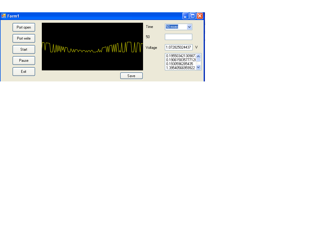

Sir, I am Designing PC Based oscilloscope on my own by using visual Basic 2008 Express edition with the help of MSP430rf2500 Microcontroller. what i want is to display an analog signal on oscilloscope window on computer. i designed oscilloscope window(form 1) my level best. i connected an analog signal to A1 pin from function generator with a frequency 25hz.
Black Box (Picture box) is going to display an analog waveform
i used temperature sensor moniter program to get an analog signal and transmited from access point to end point. ENd point  which is connected to USB port
after running program , oscilloscope displays a signal but not exactly what im looking. its looks like an noise signal. see below
please help me. my question is
1.how can i get an pure analog signal on oscilloscope window?
2.how to get all ADC Value (from 0000, 0001, 0002,0003, 0004.,005 upto 1024) through hyperterminal? if i get all ADC values it will show pure sine waveform.

    Are you sure that temperature monitor program sample rate is high enough for 25Hz signal? You need at least 250 samples per second sampling rate here. If sample rate is less than 50Hz, then output most probably will be like you see now - seemingly random data.
    Huh? What's exactly your problem? I would say: use hex coding and that's it. If data shall be human-readable in hyperterminal, then show it as ASCII decimal numbers.

    ADC10SR (sampling rate) is 50ksps(from datasheet) which is greater sampling rate than you mentioned(250 samples) . so that i gave 25hz analog signal (sample rate = 2* input frequency).
    in my visual Basic program, i'm export hyperterminal value to picture box via serial port. oscilloscope wondow draws a line as per hyperterminal value . but my hyperterminal output looks like this as below
    This is capability of ADC, not necessarily actual sample rate. How often ADC values are actually read and transmitted to your application - is completely different thing. You shall check not only how fast ADC sample your input but how often those samples are sent to your software! Again I highly doubt temperature monitor application will update reading 50000 times per second. Try to set 0.1 Hz on your function generator and check graph you are getting in result. Try to add timer to your host software and count samples per sec it receive.
    p.s. Oscilloscope with 0.5Hz bandwidth... cool :)

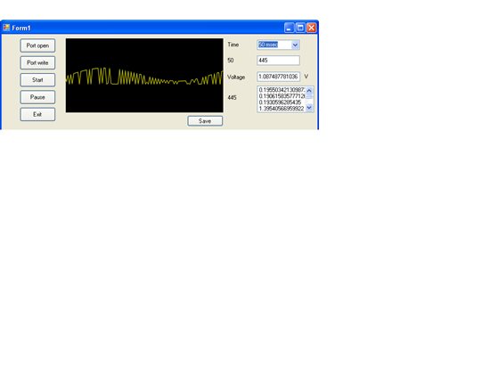

  • Sir,
    i changed my input to 0.1 Hz. now the output gets improved compared to previous result. thanks for this.see below
    please look at the Red 1 area, it looks like a good result that i want. here the hyperterminal values are 1.58768, 1.62324, 1.784673.
    But in the Red 2 Area, i dont want this result. here the hyperterminal values are as follows

  • Your "sine" is clipped. It seems that your ADC is getting not only positive but also negative voltage input. You need to set DC offset for your generator like 1V and let it output +/- 1V AC signal resulting voltages in range 0 upto 2V.
    i dont want the green coloured values.
    Obviously :) Debug your application and find out where those wrong values come from. At the moment nobody can tell you because not enough info.

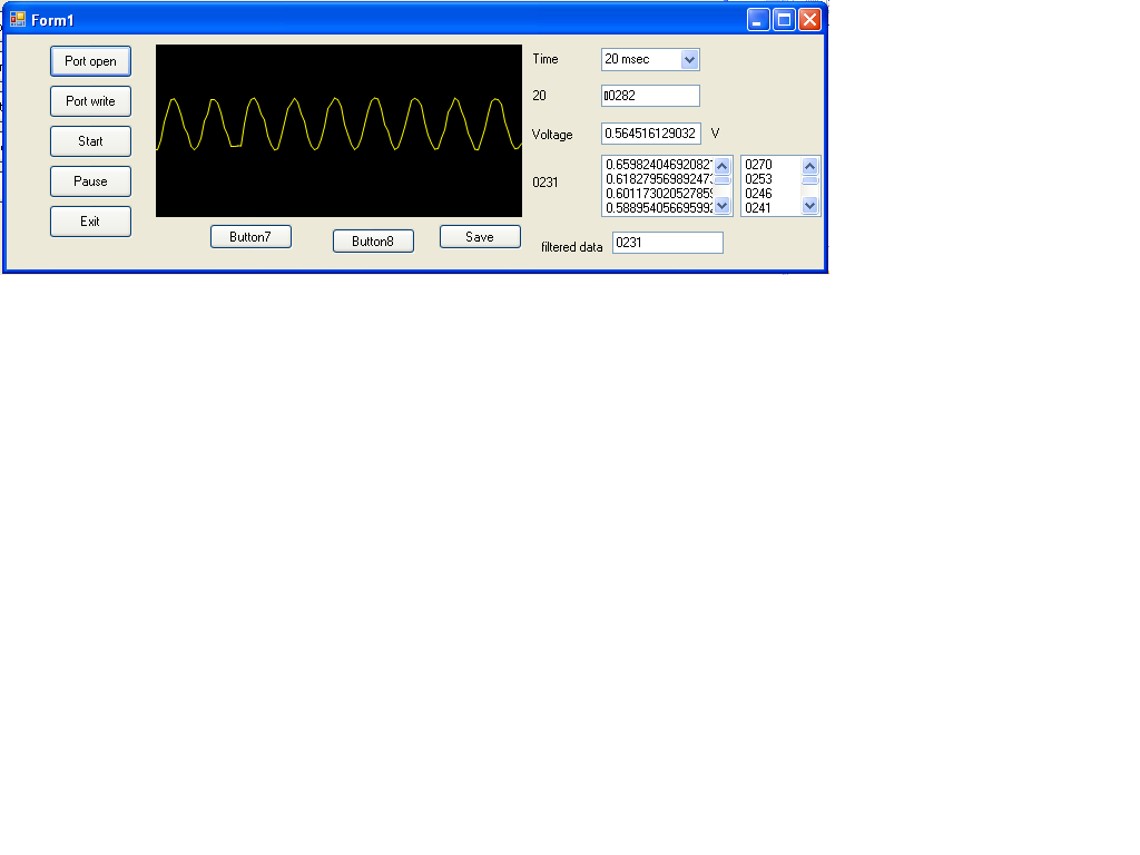

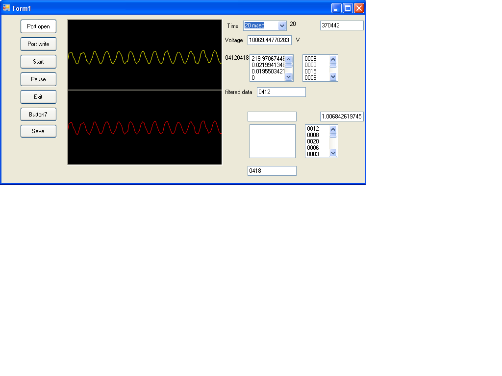

  • finally i got output. look below
  • thank for your suggestion in previous post. Now i am going to design 2 channel PC based oscilloscope on my own. i changed my microcontroller(MSP430rf2500) program for another analog input. i sent two different ADC outputs to serial port. my question is how VB program differentiate two different ADC outputs through serial port.
    Easily. Add one extra bit if information. In case of 10-bit ADC you need to add 1024 to 2nd channel samples. In VB when incoming data >= 1024, you just know that it's 2nd channel data, substract 1024 and use data.

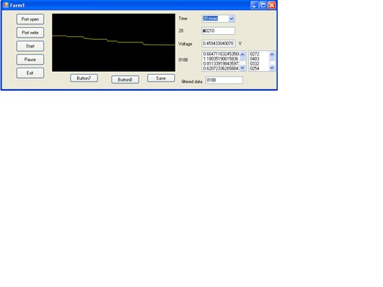

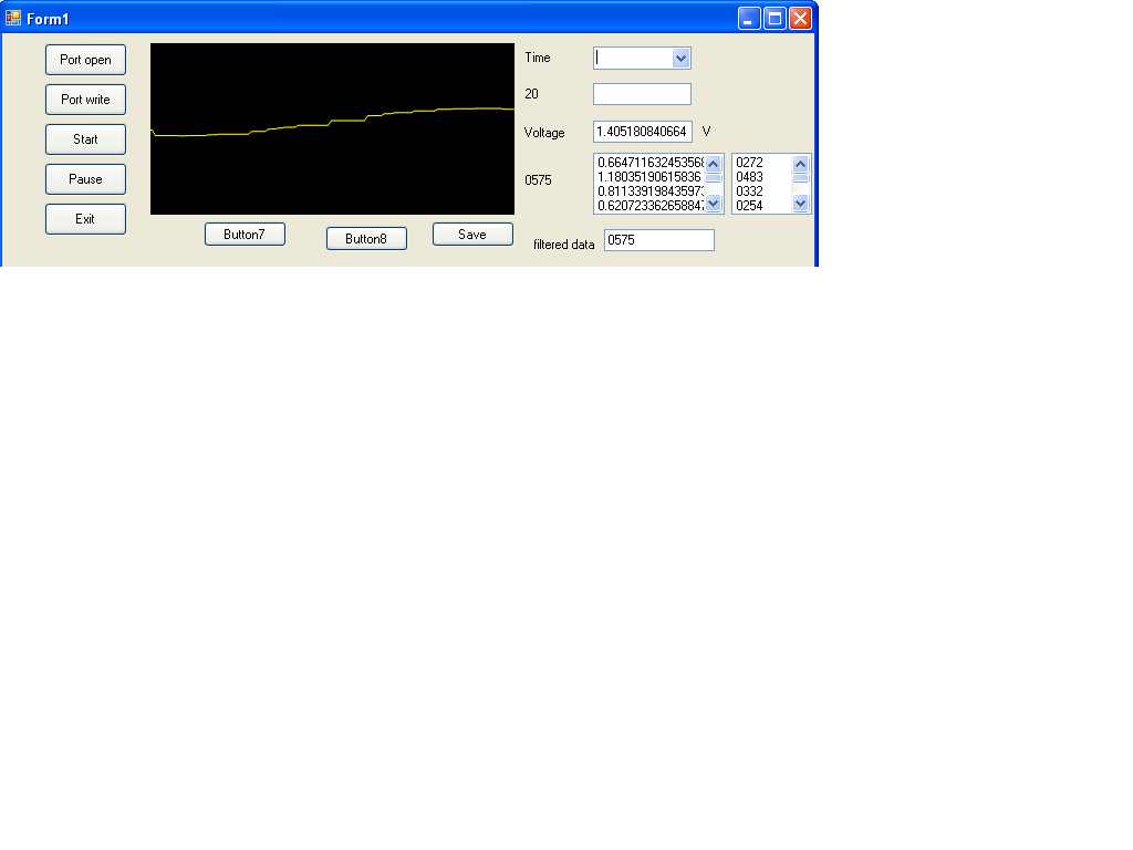

  • sir im using different way. please clarify me my procedure is correct. i am going to show hyperterminal as 8 digit data(XXXXYYYY). first four digit(XXXX) for first channel and the next 4 digit (YYYY) for second channel. when i ran my program, my first four digits(XXXX)  were only changing. but not YYYY. why it happened?
    Debug it :)
  • Sir, I debugged it. my hyperterminal output as below. if you see first four digit, it provides good result decreasing  from 0499 to 0104 and again increasing 0104 to 0499.
    but in the Next four digit, the output is not oscillating . it provides poor result compared to first four digit. i need YYYY as XXXX.

  • Good news. Now i got output. My YYYY digit keep oscillating as XXXX. I changed my microcontroller program
    for channel 1
    ADC10CTL1 = INCH_1 + ADC10DIV_7 + CONSEQ_3;
    for channel 2
    ADC10CTL1 = INCH_1 + ADC10DIV_6 + CONSEQ_3;
    now i go for VB Program for 2 channel Oscilloscope.  illmars sir ,  thanks for supporting.
    This looks a bit strange.
    First, the ADC10 requires a clock frequency of 0.45 to 6.3MHz. With ADC10DIV_x you divide the selected clock (ADC10OSC by default, which is 3.7..6.3MHz). As long as this doesn't move the resulting frequency outside the allowed range, this shouldn't have any influence on the conversion.
    Of course, the clock has an influence on the sampling time. A high sampling time results in a low-pass filtered input signal. But not too much. A too-short sampling time may lead to incorrect results, especially if the signal source is high-impedance.
    Nevertheless, the sampling time should be selected using the ADC10SHT_x bits.
    I'm surprised that you use CONSEQ_3. It means you convert a repeates sequence of channels. So the ADC10 wil convert INCH_1, then INCH_0, then INCH_1 then INCH_0. But you only use one conversion result (maybe the first - if you read if quick enough.
    My suggestion: use ADC10DIV_1 or _2, maybe set ADC10SHT_1 or _2 for a higher sampling time. Then use CONSEQ_0 for one single conversion. And change INCH_x to convert exactly the channel you want.
    I think you current success is pure coincidence by matching the converison tiem with the code execution time, so you'll get the 'right' result in time. Any change in your code will likely break this again.
    Yes, In microcontroller program , i set my timer in millisecond. so that the hyperterminal displays data for every 1millisecond.  my application is to sample both 2 channels at the same time. here my channel 1(first four digit XXXX) and channel 2(Next four digit YYYY) are oscillating.
    Sir , Please clarify me that my approaching is right?
    As your suggest i changed what you mentioned. No difference in the output . just same output as what i got in previous settings(ie:  (ADC10DIV_6 and CONSEQ_3)
    Here is my output

  • this is my 2 Channel Pc Based Oscilloscope. Thanks to everyone, illmars and Jens. :)
  • Congratulations. Looks nice too.
