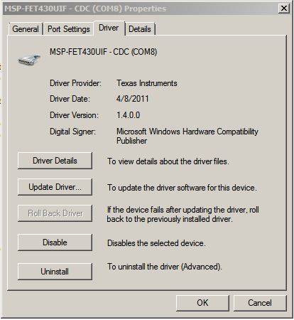

Hi to all,
I'm looking for MSP430 USB Debugging Interface device drivers ver. 1.4.0.0. When trying to download the MSP430ware bundle, I found out that only 1.30.0 driverlib was available on www.ti.com.
Is there a chance to get the latest device driver? Could anyone provide additional information about it?
Thank you in advance
Best regards

  • Hi David,
    Thank you in advance for your quick reply. I summurize in few words what I've expected to find: I need to work with MSP430 USB-Debug-Interface (MSP-FET430UIF) (P/N: MSP - FET430U28A), since I'm not abel to use the software CD delivered with the hardware, I was supposed to download it from the TI website. Doing so I felt pretty confused when surfing on the pages in order to find a downloadable driver. I must confess It's first time I use this hardware and maybe need having ideas to be clarified about this device.
    Concerning the 1.4.0.0 version I mentioned above, I simply got this number by right-clicking on the Properties button in the Windows XP (SP3) Device Manager on the item representing the device. Is that value incorrect? How can I get the correct driver version?
    Best regards and have a great day!
    Matteo
  • Matteo,
    It looks to me that you already have the UIF driver installed on your PC if you are able to right-click and see the driver properties.  When I do this on my PC, I see the same driver version 1.4.0.0.
    So, I'm unclear on what you want to do.  What software are you trying to use with the UIF?  Code Composer Studio (CCS)?
    The software on the CD contains a size-limited version of CCS.  I don't know why you cannot use this, but you can also download CCS from here: http://www.ti.com/tool/ccstudio.  Scroll down and click the "CCS-Free" under "Order Now".
    David

  • Matteo,
    The UIF driver will get installed with CCS.  Download and install the free CCS version I cited previously, and you should get what you need.
    - David
  • David,
    this is the information I was looking for. I marked you reply as solving answer.
    Have a nice day.
