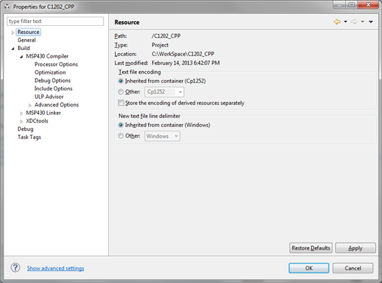

  • Thank you for all of your inputs, but pressing button "Restore Defaults" worked like a charm.  I must have changed a setting that caused this problem.
  • Silver Diamond said:
     I must have changed a setting that caused this problem (sic)
    But, again, you have not show any actual problem in the behaviour of the tools!
    The so-called "problem" is, in fact, perfectly valid and correct behaviour - until you understand this, you will keep falling into the same trap!
