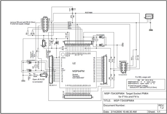

  • What was your motivation for providing external power to the MSP-TS430PM64?  Are you powering the MSP-TS430PM64 externally while you are trying to program it using the MSP-FET430UIF?  The MSP430F2481 can be powered from the MSP-FET430UIF during programming.

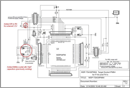

    What changes did you make to the MSP-TS430PM64?  I've attached a copy of the schematic.  If you could mark it up with yoru modifications, it might be more clear.
  • I removed the 0R resistor from R8 and placed a new 0R resistor on R9.  I am powering the target through J5 (VCC - 3.3V, GND -GND).  This configuration was working a week ago.
  • What results do you get when you remove these modifications and revert the MSP-TS430PM64 back to the original schematic?
  • I revert back to the original schematic and I get the same error.
