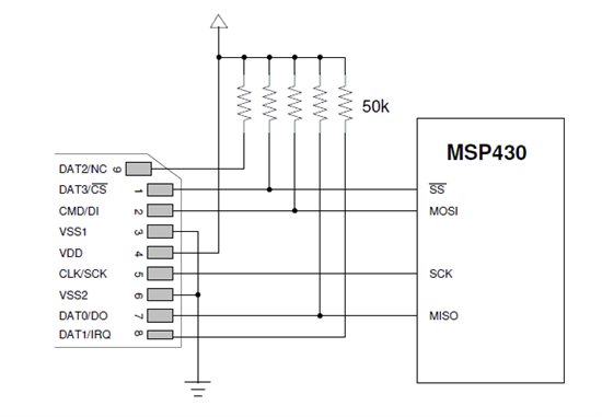

I want to communicate SD card with MSP430G2x53 and G2x52.
1. i struck with the connection between MSp430 and SD Card, I refer one Texas Instruments Datasheet(sdcard_appnote_foust_3.pdf) on SD Card Interfacing, but i can't find that pin outs in MSp430G2452 and 2553,Please Send me about the SD Card connecting with MSP430 .
2. or How do i Interface SD card with MSP430 ?

    2. and another thing is They are given in  following  Image SS,MISO,MOSI and SCK I can't find this I/O pins in MSP430G2452 and MSP430G2553.
    3. Iam Using MSP430 Microcontroller
    Those are the "standard" SPI signal names, as used by Motorola (now Freescale) - who invented it.
    It's not hard to find what they mean and, thus, relate them to other names used by other vendors:
    http://www.lmgtfy.com?q=What+do+SS+MISO+MOSI+SCK+mean%3f
    The SD Card specification would also help you - see previous links...
    On the 2553, you have an USCI module, so the pins are either UCA0CLK/UCA0SIMO/UCA0SOMI or UCB0CLK/UCB0SIMO/UCBCLKSOMI, dpending on which SPI you want to use.
    On the 2452, there is no USCI module but an USI module. Here the pins are named SCLK, SDO (data out = SIMO in master mode) and SDI (data in = SOMI).
    SS is a chip select signal and a plain GPIO pin, controlled by the MSP software. Any unused GPIO pin is fine.
