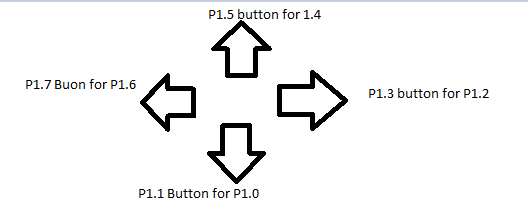

When I am using one button I have no problem. But I wont to more buttons. Example in my code. When I use P1.3 button. P1.0 active or I pressed P1.4 button P1.0 active.
But I am doing P1.3 button but P1.4 button isnt working.
Thanks u

  • I want this. A car when I press button forward or back or right or left. I want this.

  • If you only are interested in toggling a LED when corresponding button is pressed.
    and as you have bits X_X_X_X_ for inputs that
    have the LEDs bits    _X_X_X_X for outputs.
    A simple shift right should do.
