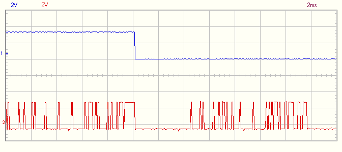

  • A little progress : I have enable URXEIE to be able to see what byte are skipped.
    The reception always start with a BREAK error then a Framing Error with the 2 first bytes packed in 1 byte. When there is no Framing Error, the 2 first bytes are correct.
    So I think there is a problem on the receive buffer when I switch the DE line. I have try to insert a delay between the change on the DE and enabling received, but with no luck.

  • The red trace on the right side of the scope trace you posted looks like it is the wrong polarity. For NRZ encoding (standard on async UART) the idle state should be a logic high when looking at the CMOS side of the 485 transceiver.
    That to me would explain the break and framing errors.

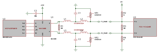

    Which RS-485 chip are you using? Is it possible that you have the receive differential lines backwards? Can you post a picture from your schematic showing how that part of the circuit is wired?
  • There is the schematic.
    I use a MAX3486.
    The "TX_RS485" and "RX_RS485" goes to the motor. I have try to exchange the line that go to the motor but nothing works then.
  • Do you have the schematics for the other end of the circuit, at the motor? It still looks like inverted polarity on the data coming from the motor. Is that something that is selectable on the motor controller?
  • A lot of times, a RS485 half-duplex interface is also multi-drop, which needs to address devices before they respond. There are two modes in the MSP430 UART that do this. One is Address-Bit Multiprocessor Format, which sends 9 bit data instead of 8 bit. The 9th bit is used to flag whether the serial data being transmitted is an address or data. There is also a Idle-Line Multiprocessor Format which generates idle frames between transmit and receive packets and sends an address character.
  • The main problem was electrical. RS485 lines need a pullup and a pulldown in addition to terminators :
    Not exactly in addition. Pullup/pulldown are on one side of the bus, terminators on the other end (if all peers aren't moee than a few cm from the bus). RS485 isn't really suited for a star design (with a terminator on every peer) even though we use it this way without too many problems.
    In any case, R3 is superfluous an only increases the current consumption.
    Also, the combination of pullu/pulldown and terminator resistance causes an idle voltage of only 0.23V on the differential lines (0.115V if R1 and R3 are populated). Probably not enough to ensure a stable idle signal on a distorted bus.
    You should really raise R1 and remove R3. Or, if you really need that strong a termination, lower R2/R4. But keep an eye on the maximum driving capability and slew rate of your RS485 driver.
