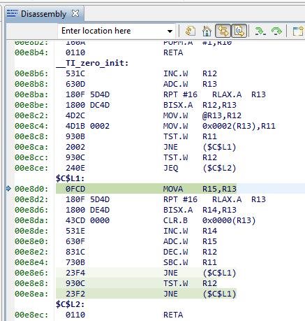

I am running CCSv5.3 and attempting to debug an MSP430F5308 on a custom board. The program loads, runs, and debugs properly if my un-intitialized variable arrays stay below ~1000 bytes. However, when I attempt to load the program with variable arrays larger than ~1k bytes, the program loads and runs but does not make it to main. It appears to be looping around
 __TI_decompress_none
or
__TI_zero_init
or
UCS_initFLLSettle
I am confuse as to why un-initialized variables (RAM) would affect code running in flash. Can anyone suggest a way to debug this issue?
Here is a snapshot of the area where the program is stuck in a loop.
Does anyone know what may be happening?
This is now happening consistently.
  • Hi Mike,
    I have seen this many times before - what is happening is that your Watchdog timer is expiring before you ever make it to your main() for your program to be able to kick it or disable it. This is why it happens only once you have a certain amount of RAM being initialized.
    The reason this happens is that before you get to main, your array is initialized with data - if this takes long enough, the watchdog can time out and reset the part, causing the loop you are seeing. Here is how you can get around it: in CCS, you can use a function called __system_pre_init() that is called before your variables all get initialized - there is already a stub definition for this function, you just overwrite it. In there, you can disable the watchdog and your issue should disappear. For more details please see this other post: http://e2e.ti.com/support/microcontrollers/msp430/f/166/p/221152/778687.aspx#778687 I also list some other options there, like how to disable zero-initialization of your empty arrays.

  • Many thanks Katie.
    For completeness for others who stumble on this thread, in IAR, this function is called __low_level_init()

  • Hi Mohsen,
    __system_pre_init() is just a stub function in CCS that you can overwrite with your own version that includes code to disable the watchdog. I've attached an example:

    You can put it in its own file, or in your main code file, wherever you'd like, just like any normal function that you create.
