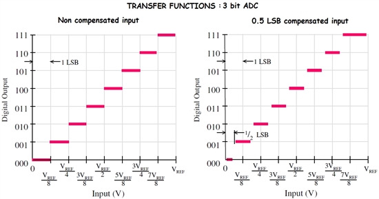

    For example, consider an ideal 3 bit ADC transfer function (figure below): The vertical axis shows seven intervals (2^n-1) and horizontal axis shows eight intervals (2^n). This is true also for 0.5 LSB input compensated ADC. The final transition (from 110 to 111) occurs when input reaches 1 LSB below Vref or 1.5 LSB below Vref. In other words, the transfer functions are something like:
1. For an ideal 3 bit ADC with no compensation on input:
Nadc = int (Vin/Vref*8)
2. For an ideal 3 bit ADC with 0.5 LSB compensation on input:
Nadc = int ((Vin + 0.5 LSB)/Vref*8)

  • Did you count the number of different values in your drawings? You can't express both, 0 and Vref if your step size is 1/(2^n). So if 1LSB has the value of (1/8)VRef, you have 9 different values from 0 to VRef.
    Those ADCs with a Vref*1/(2^n) step size can't give Vref as result. It is not a matter of compensated input or not.
    IMHO, it is better to have both, 0V and VRef in the output rage than to have the (already rounded this or that way to 1 LSB) values adjusted on voltage levels that are a 1/(2^n) fraction of the reference.

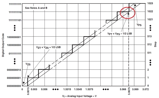

    Page 13 of TLV1549 datasheet (10 bit ADC):
       Notice on this plot, that 1 LSB is 3 mV ( = 3.072/1024). The final transition occurs 1.5 LSB below some suitable Vref. The vertical axis shows 1023 intervals (2^n-1) and horizontal axis shows 1024 intervals (2^n).

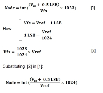

       Both examples are consistent with the plot and equation showed on my first post (based on 2^n factor, instead of 2^n-1). On second example, with 0.5 LSB input compensation, we have (note the value 1024):
    Nadc = int((Vin + 0.5 LSB) / Vref * 1024)
    Not convinced? Then, I show: For Vin  = 3.0675 V:
    Nadc = int((3.0675 + 0.0015) /3.072 * 1024) = 1023   (In accordance with the plot)

       I'm glad you understood my request. I also hope that the company can respond soon. Meanwhile, I anticipate that someone can to find a way to put the 1023 factor on AD conversion equation. For example, replacing the Vref voltage by Vfs (full scale). So, regarding the previous plot, such equation would be:
          Nadc = int ((Vin + 0.5 LSB)/Vfs * 1023)
           In this particular case: Vfs = Vref - 1 LSB
      Just do the math and realize: This transformation does not add anything new, only confuses even more. It's just a different way of presenting the same information.  Also, the MSP430 User’s Manual  says nothing about Vfs, only Vref  (indeed, would be no practical to work with Vfs).

  •       After thinking a bit more about the subject, I guess there is a possibility I have already answered a piece of my question without intending. See the figure below, which I presented in a previous post:
          All could to be explained if TI names Vfs (full scale) as its Vref. It would be just a naming issue? Well, this has happened in the past, for example: Regarding SPI, TI uses UCCKPL name instead of CPOL, and its UCCKPH is the inverse of CPHA (gain -1).
          I do not know exactly what happens inside the MSP430 ADC (the path of the signals, gains and so on). Maybe the voltage applied to the Vref pin could  be transformed internally into another Vref ' voltage (with gain), so that:
    Vref ' = 1024/1023 * Vref   (yes, I didn't write wrong)
         In this case, both expressions below could be correct (assuming 0.5 LSB input compensation):
    NADC = int ((Vin + 0.5 LSB) / Vref * 1023)
    NADC = int ((Vin + 0.5 LSB) / Vref ' * 1024)
         For example, with a voltage applied on Vref pin = 2.5 V (to facilitate, not using fixed point):
    NADC = int ((Vin + 0.5 LSB) / 2.5 * 1023)
    NADC = int ((Vin + 0.5 LSB) / 2.50244... * 1024)
    Similar operations could be applied on 12 bit ADC, too.  Although seem a plausible explication (MSP430 ADC transforming internally Vref into Vref ' ), I'm not sure.

  • Rodrigues said:
    TI seems to be the only company that shows 2^n-1 factor on ADC conversion equation (where "n" is the ADC resolution).
    Jens-Michael Gross said:
    it is AFAIK the natural outcome from an SAR ADC with charge distribution method.
        No Jens. You are wrong.

  • All,
    Sorry for the confusion and long wait. Here is the proper calculation for  1LSB = (VREF+ - VREF=)/2^n, and of course the last code will saturate to 2^n-1
    Typically:
    If Vref+ = REF and Vref- =0,
    Code = Vin x *2^n /REF, so for a 12-bit ADC, 1 LSB=REF/2^n.
    Vin=0 => Code=0
    Vin=REF – 1LSB => Code=4095, beyond this code saturates at 4095 (12b unsigned representation).
    The codes are equally spread between 0 and 4095.
    We believe this is not made really clear in our documentation and apologize for the confusion. Attached is a representation of this answer.
    JH
    6114.ideal_transfer_function.pdf
  • JH said:
    Sorry for the confusion and long wait. Here is the proper calculation...
    ... Code = Vin x *2^n /REF
       Hi JH,
        thank you for coIlaborating, but I confess not be fully satisfied with the depth of response, considering the delay. But OK, let me see if I understood right:
    With Vref- = 0, then the expressions
    Nadc = Vin * 1023/Vref+      (for ADC10)   [1]
    Nadc = Vin * 4095/Vref+      (for ADC12)   [2]
    shown on User’s Manual for several MSP430 families over a decade, would be wrong?
    And the correct expressions would be:
    Nadc = Vin * 1024/Vref+      (for ADC10)   [3]
    Nadc = Vin * 4096/Vref+      (for ADC12)   [4]
    Could you confirm this?
                Another evidence for the fact expressions [1] and [2] would be inaccurate, is to note that the transfer function plots you attached are consistent with the 2^n factor, instead of 2^n-1, being also similar those I presented in my first post. The expressions would make more sense mathematically by using the int() function.
                Also: The answer did not include something about the ADC input compensation schemes (in LSBs). The distinctions between Vref and Vfs (full scale) were not considered, as well. Of course, if that were important in clarifying.
    Dirceu Rodrigues Jr.
