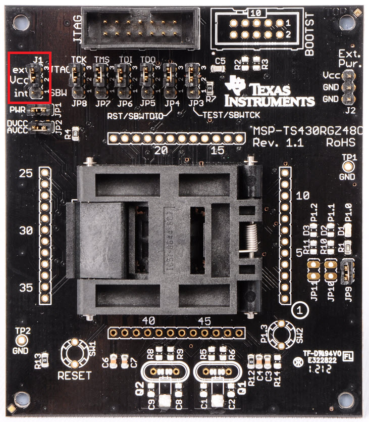

  • Hi Jordan,
    What revision of MSP430FR5969 do you have? You can find the revision letter in the markings on the top of the part.
    Are you using the MSP-TS430RGZ48C target board, or a custom board?
     Can you confirm what position the various jumpers are in on your FR5969 board? Specifically, if you are wanting to power the device from the FET tool, make sure that J1 is set to INT. If you want to power the device from an external source like a bench supply, make sure that J1 is set to EXT.
    In addition, if you ordered your parts in a MSP-TS430RGZ48C kit, please check the number on the kit box against the numbers in this post: http://e2e.ti.com/support/microcontrollers/msp430/f/166/p/254008/891069.aspx#891069 You are looking to see if you might have Date: 35/2012 or 38/2012.
    Katie
  • Thank you so much, Katie. I had left the jumper as it was when I received it (with Vcc set to ext). After setting the jumper to int, it worked. Finally! Thanks again!
  • Hello, how do you set J1 as int? Thanks!
  • Hi Fabio,
    Here is a picture of the MSP-TS430RGZ48C, with the J1 pins circled:
    Here you can see that in this picture, it is in the EXT position (where pins 2 and 3 are connected). To move to the INT position, move the jumper so that pins 1 and 2 are connected (you can see this is marked as INT on the silkscreening).
    Katie
