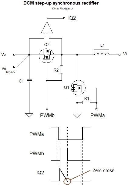

  • My design, to be published in a magazine soon.
    Well done! I just wonder why series diode if you are doing synchronous rectifier?
        For sake of simplicity, my proposed converter is not based on synchronous rectification. The two leftmost MOSFETs (N and P channel) serve only to enabe/disable the converter. This is useful in a battery-powered system to avoid power consumption when the drive is off (eg start-up). Otherwise, there would be a direct path between input and output through the diode. Also is useful in the stages of development/debugging. When the converter is operating, pin P4.3 remains on high level.
        I decided to implement a DCM converter due to its advantages: High efficiency on light loads and design of controller made easier (the transfer function has a single pole - the second pole and RHP zero are insignificant). To use true synchronous rectifier, the complexity of the system is increased since it is usually required to detect the zero crossing current on high side transistor in order to turn it off (what happens when operating in DCM). I've been working on this application – see the figure below. Note that in this case both transistors are N channel, so the PWMb signal must be boostrapped to a higher voltage.
        Despite the MSP430 contain a flexible timer (mainly the up/down mode), believe in me: It would be difficult to ensure the correct polarity of involved signals under all conditions (eg startup, turning off the converter, duty-cycle changing and so on). Any errors could result in catastrophic consequences (remember that it is the MCU main power). All this only to save a fraction of the voltage drop caused by the replacement of a Schottky diode by a MOSFET. Efficiency comes at a price.

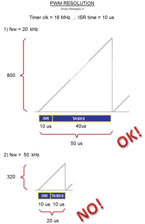

  • Rodrigues said:
    switching frequency is 20 kHz
    Why so low freq? Why don't you do like 50 or 150 kHz? Can't keep-up with regulation speed?
         It's all about resolution. The higher the PWM frequency, the lower resolution available. Follow the figure below. Assuming Timer in Up mode, having a 16 MHz clock (no prescale). Also consider the controller running on ISR for 10 us (loop control). With a 20 kHz switching frequency, the maximum timer value is 800 (a slightly lower resolution than 10 bits), leaving 80% of free time to perform tasks from application. Now at 50 kHz, the maximum tiimer value is 320 (a resolution slightly better than 8 bits), leaving only 50% of free time to perform other tasks - more or less like every 2 instructions, one is dedicated to the controller. No way. It will be impossible running at 150 KHz, as you asked (due to timming and low resolution, the system could become unstable). The problem only gets worse changing the timer to Up/Down mode. In this case, for the same switching frequency, the resolution would be halved.
        For this reason, I made reference to specialized peripherals present in DSPs and DSCs (high resolution PWM units).

  • Rodrigues said:
    As I showed, the 20 KHz value for MSP430 is just a good compromise between PWM resolution (too low will make the control system useless) and free time for the main task
    Why you talk about CPU time here? Because software controlled sync rectifier plans? Otherwise it is not required to update PWM duty cycle each cycle meaning that CPU time for 20kHz and 150kHz PWM will be the same and supply stability too.
  • llmars said:
    ...is not required to update PWM duty cycle each cycle meaning that CPU time for 20kHz and 150kHz PWM will be the same and supply stability too.
       Even if you could perform the controller update say, every four or five PWM cycles, there's still the problem of PWM poor resolution. With a 150 kHz switching frequency, the maximum timer value (@ 16 MHz clk) is 106​​. That is, you will have no more than 106 different values for duty-cycle; a resolution close to 7 bits (not counting 0% and 100%). So, depending on the application, could result in an inadequate controller (big overshoots, instabilities, limit cycles, and so on). As I said, with a High Resolution Timer (present on DSP / DSC, but not on MSP430), this problem would be minimized.
    Have you ever heard of component named "big enough capacitor"? Also did you pay attention to my initial regulation specs (2.5 - 3.3V)? Other name of it: supply ripple voltage. Yes, THAT big. All this means that supply can have rough regulation and still be fine. I don't want my supply to have fast step load response either - no need.
    Rodrigues said:
    Probably result in an inadequate controller (big overshoots, instabilities, limit cycles, and so on).
    That's the main idea here - (have to repeat) that supply is integral part of device, it's regulation loop can/shall use estimated load information available to regulate most efficient way. Having properly sized capacitor and information about expected load, overshoots and other kind of instabilities can be avoided.
    PWM frequency is not so important actually, most probably I select "tradeoff" around 62.5kHz, 8 bits PWM.

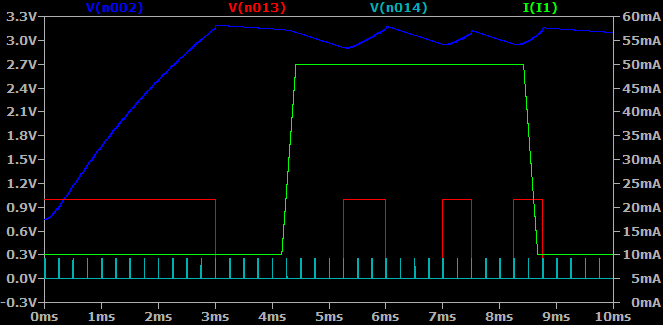

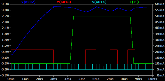

  • Picture below how I expect supply regulation will look like. Well, first 3ms start-up is just simulation side-effect because in real life battery gradually will discharge to 0.9V level and regulation will gradually tune to incoming voltage.
    Dark blue trace: voltage on storage 220uF cap. Green trace: load 10mA-50mA-10mA step. Red trace: PWM enable signal, light blue spikes: time when simulated supply makes and changes "decisions" - to enable PWM or not. PWM of 800mA coil is fixed at 75% here. What this is all about - not PWM resolution or gradual regulation demonstration but to prove that knowing max load you can size your capacitor such a way that supply can't "run away" while you are not regulating it (C = I*dT/dV), in this case "blank time" is 1/4000 sec. To further improve this, supply can regulate more aggressively during (start of) high load, like 8000 regulations per sec or even faster.
    Screw small ripple voltages and ultrafast load regulation ;) As long we are live and voltage in range - everything's fine.
